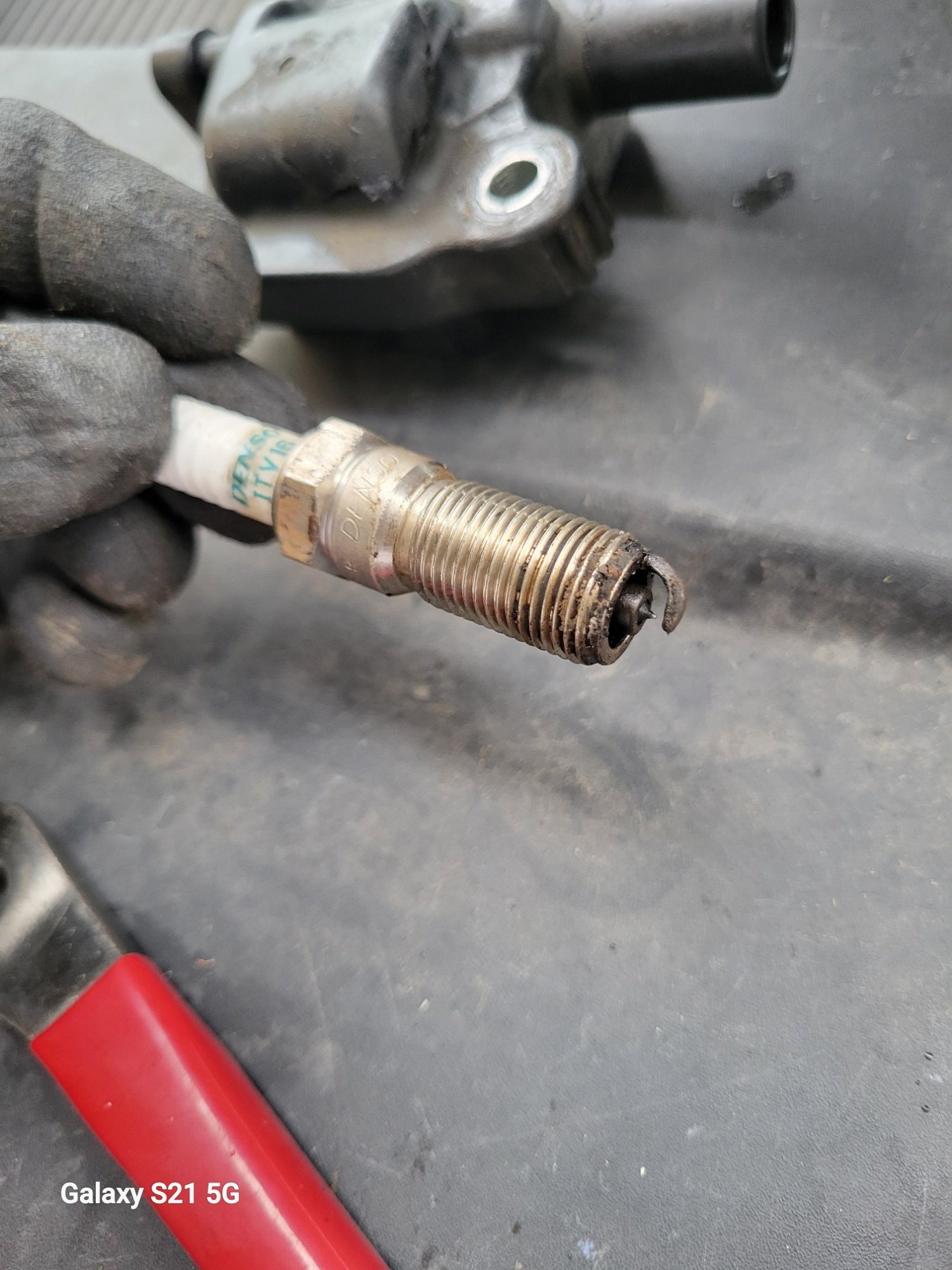

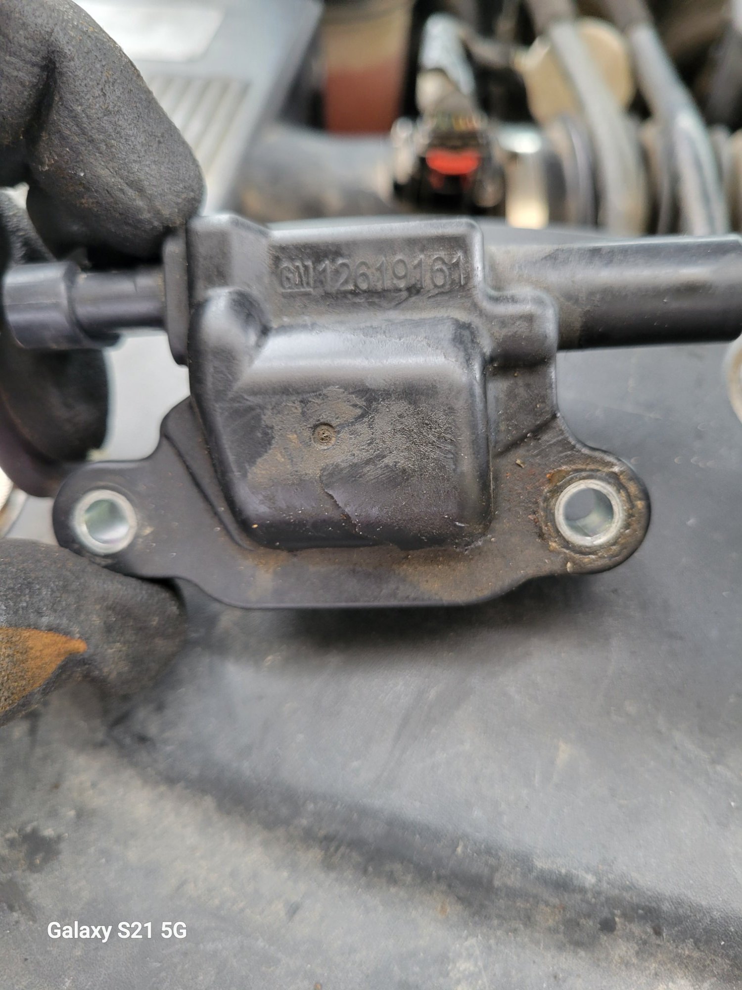

Note to self: check for spark. Leaking heater core hoses need to be dealt with ASAP...
Edited by Snowcamo
I assume since the rear passenger coil is located directly below the heater core hoses. Hot antifreeze, it was wet.  I'm going to order a new coil and connector put them in and roll on.
Edited by Snowcamo
Iirc cylinder #8. Passenger rear next to fire wall. Im glad it was simple to find. I found I had no spark from that plug and went to swap coils. Just before I bolted that coil to another location I saw the Crack. The coil and connector will be here this weekend. I'll report the findings. All will go well I'm sure.
