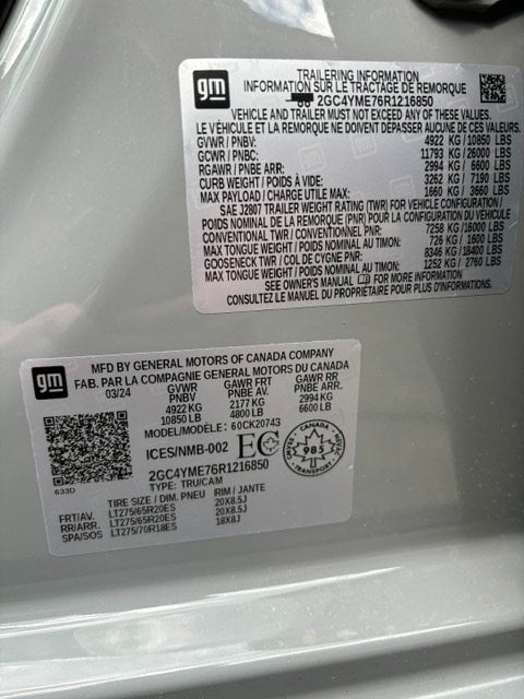

Here is our inside door sticker

I have a 2024 Crew Cab 4x4, the door sticker says 3417 lbs payload and 16000 lbs conventional trailer, 1600 lbs tongue weight.
We pull a 2026 ~38' Forest River Cherokee Grey Wolf 29TE with a sticker dry weight of 7047 lbs and a sticker GVWR of 9995 lbs.
We just got the camper so have only done local pulls under 60 mph so tough to say what longer trips at full highway speeds will bring, but so far it's towed beautifully.  We had full propane tanks, but the fresh, grey, and black water tanks were empty (emptied at camp ground before coming home, had water hookup so didn't need to fill fresh) and a decent bit of gear, both in the camper and in the bed, but I'm not sure what total weight was.  Given empty tanks I'm confident we were below the 9995 lb trailer GVWR.
