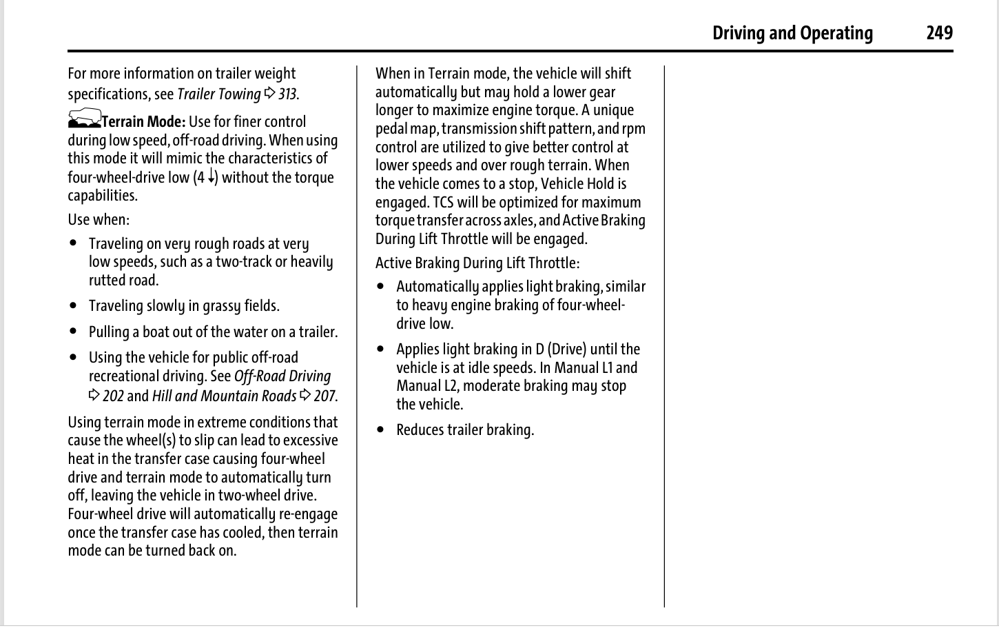

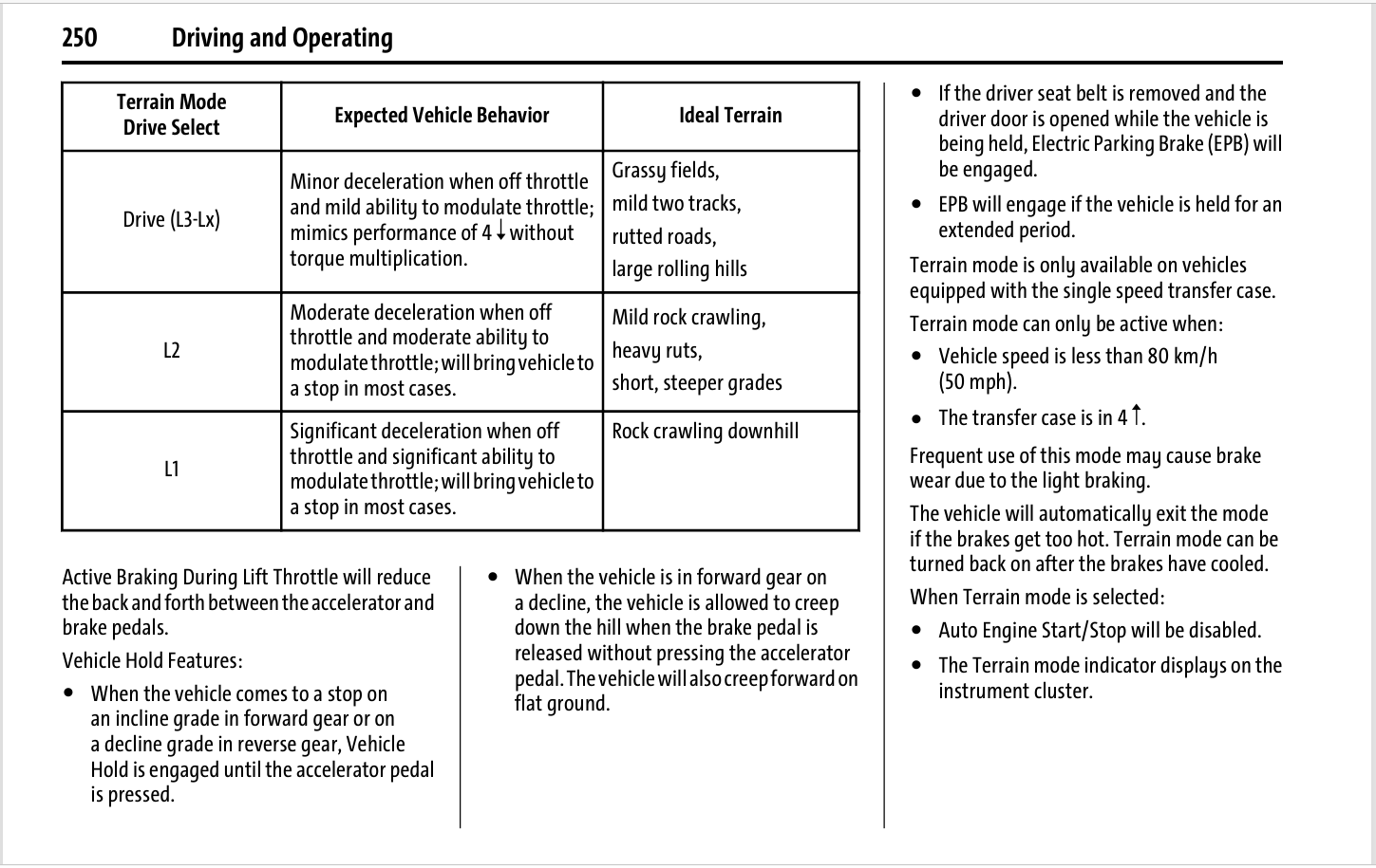

However.  GM did give those trucks with the single speed case Terrain Mode.  Terrain Mode mimics 4LO minus the gear reduction and torque capability.  It uses the ABS/braking system to perform the operation.  It also gives these one pedal driving (sort of) when in Terrain Mode via the active brake during throttle lift.
Does it have its limitations over a true 2 speed case?  Sure.  But it works.
I read through that and I won't lie, my eyes rolled at some of the quirks about how it can turn off the trailer braking for example but I can see how it could help control or even up the torque applied to the ground with each wheel in a boat ramp scenario. But of course what it can't do is increase the torque to the wheels if the need is there as it ends up being like driving the four wheel drive version of a two wheel drive ( high range that is ). So far the neighbor that ended up with the 3.0 duramax with the max tow package which meant the 3.73 gears and high range only, I think its been doing ok for what he has been towing but doubt he ventures off into the soft stuff with his holiday trailer. He may have towed his dads river boat locally with it ( he always used his 6.6 duramax before ), I'll have to ask him sometime if he got into a lack of power to the wheels situation as after all that engine produces a lot of torque at low speed once the turbo winds out a bit and I think it has the 10 speed and if so they have a pretty good first gear ratio at 4.70 I see which is vastly better than the 3 or four speed overdrive models of years ago.
