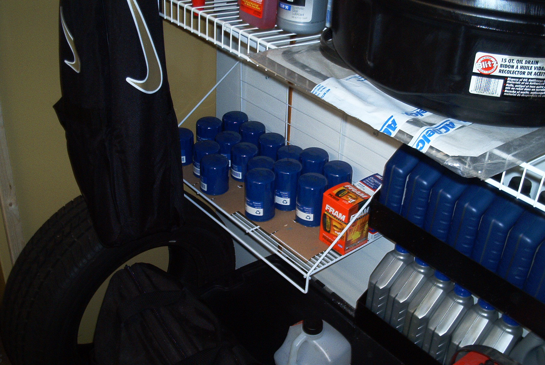

Wonder what I like??? Ac Delco for my truck and impala (buy in bulk). Fram for the 93 escort with 87K miles :cheers:
