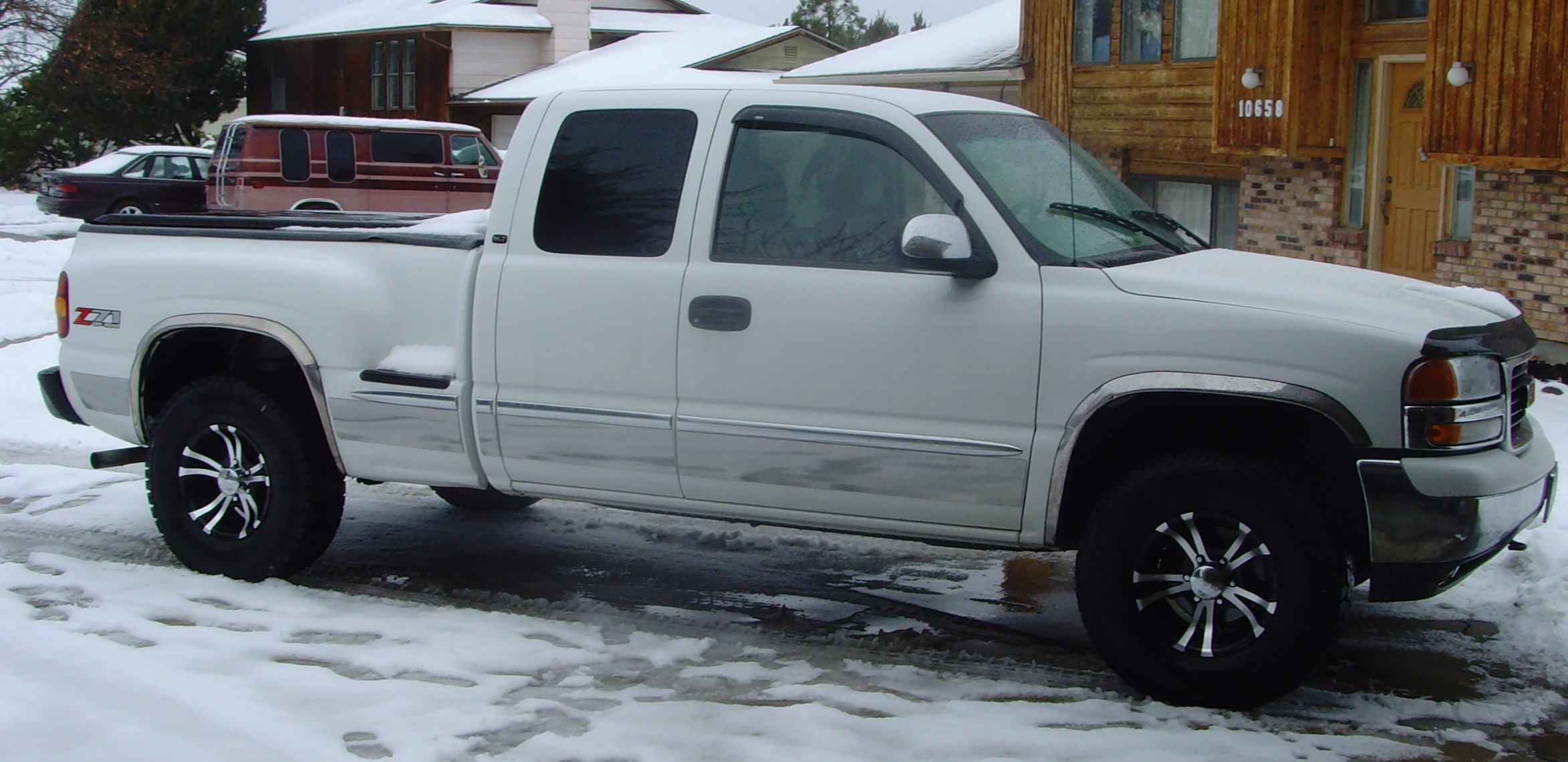

I'm running the 2.5" top gun customz leveling kit which raised the front a true 2.5". It raised the front higher than the rear so I installed a 3" block and removed the 1" stock block.
I'm running a 33x12.50x17 MT Baja Claws with no rubbing at all.
