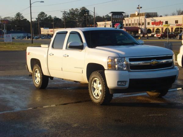

hey guys- i'm new to the forum. i have a 2008 crew cab z71 with a 2" leveling kit. i think it is a tuff country, but it may be rough country. anyways, it is the spacer that goes above the front coil springs. could i buy the other leveling kit that goes below the spring?? i don't see why i couldn't. and if any of you guys have any pics, i'd love to see it.

those 285 bfg's look awesome. i wanted them but they were E range and thought that they were a bit too heavy compared to stock tires. Oh yeah, dont do that stacking thing, bad idea. Death nail for your ball joints and I,m not sure you could make it work. Plus shocks would prob explode. If you need more heighth get a 4 inch lift.
