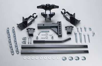

The OEM hitch is a Class IV hitch receiver. You can use it with either "weight carrying" or "weight distributing (WD)" hitches. There's a photo of WD components halfway down this page: http://www.etrailer.com/faq-weightdistribution.aspx . A standard 2" receiver insert with a ball would be "weight carrying".
