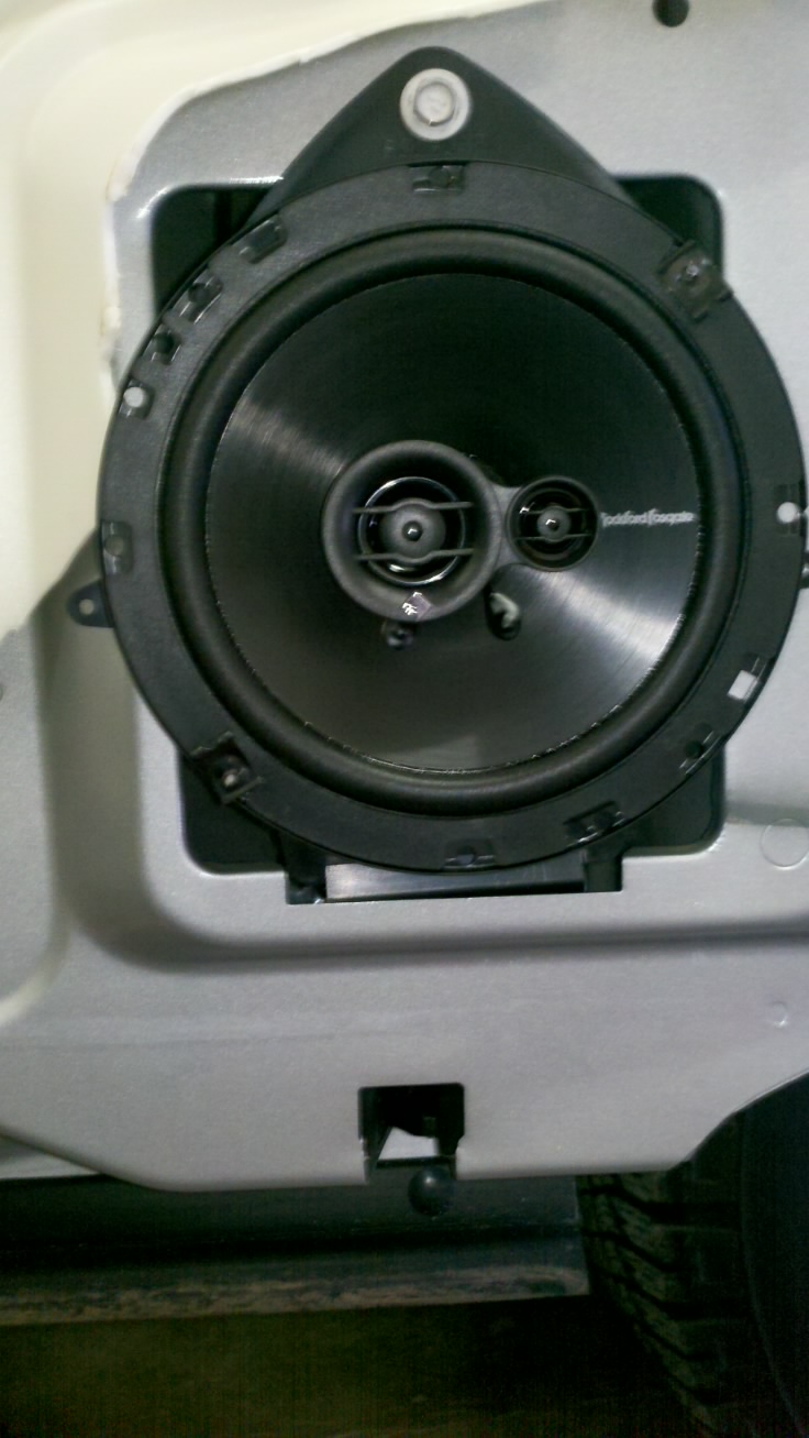

Well, so much for a fairly clean/easy install. The speaker adapters don't even fit the speakers and are not even close to fitting the rear door openings (see pics). How mortified I was to spend all the time doing this only to have sub par sound and an unforgivable amount of rattles and buzzes in my doors now. I don't give up easy but if this can't be resolved soon, I'll be going back to my factory speakers asap.
Well, after a bunch of digging around this morning I don't seem to find any company that makes the correct adaptors for the rear ext cab doors at all. Looks like the factory speakers will be going back in for now, then. :jester:
No, you are not going to find a rear door adapter for the ext cab. At least I never could when I was doing my install a few months back. I eventually decided not to bother with the rear doors anyway and focus on the fronts since the rears are so muffled and out of the way because of the seats.
And if you want to avoid alot of rattling, I would recommend crossing over your speakers to, say, 80 - 120 hz and send the lows to your sub. Even with tons of dynamat the doors will never hold up as a real "enclosure" for decent size speakers.
