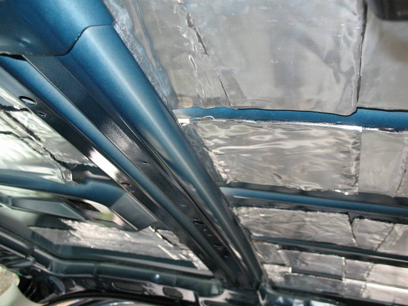

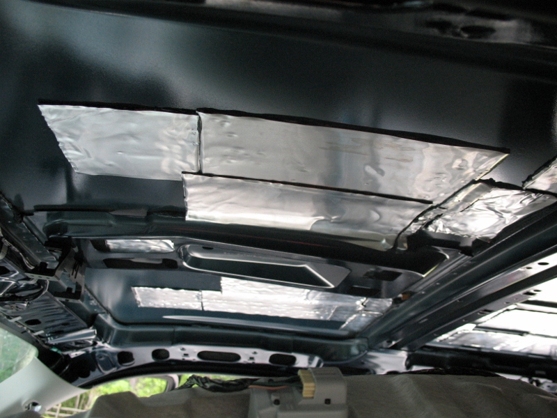

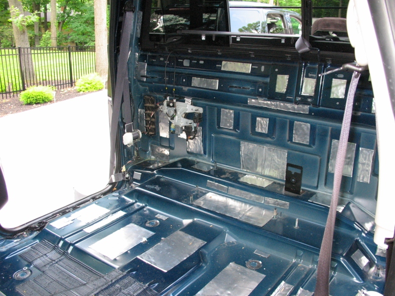

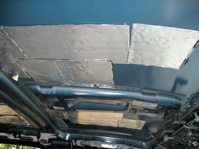

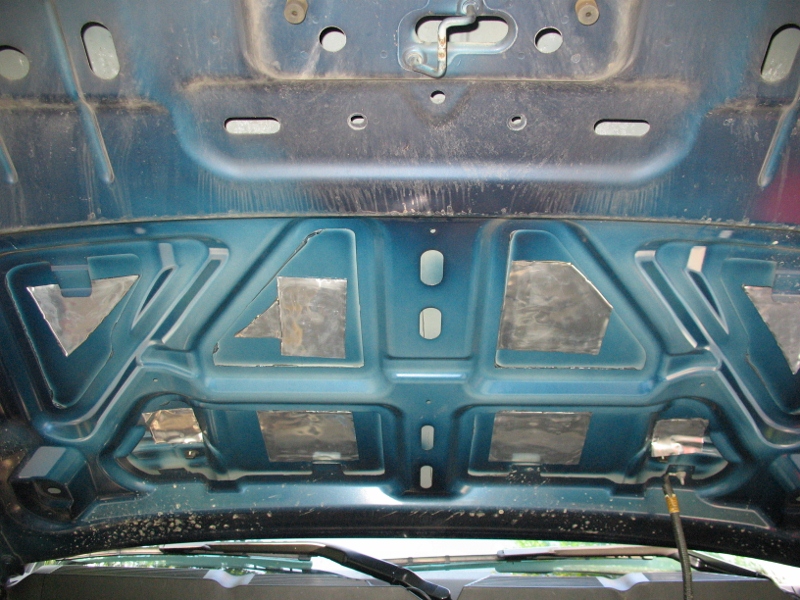

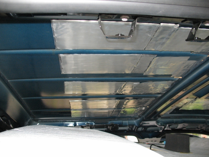

I fumbled through it a little, but was able to fix it right. I was going to do the 25% in the middle of the panel rule, but screwed up by putting them in the wrong places. So I patched in and attached a little, and got it right in the end. It is quite a remarkable difference! Hitting bumps, closing the doors, the exhaust, the stereo, are all a little different/better. The truck sounds more solid and little bumps don't rattle around so much. That roof is like a drum skin from the factory!!!! It's good now though!
I'll pick another nice day next week and work on the floor!

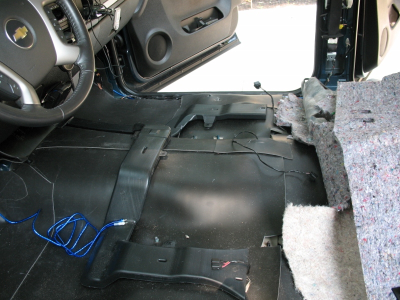

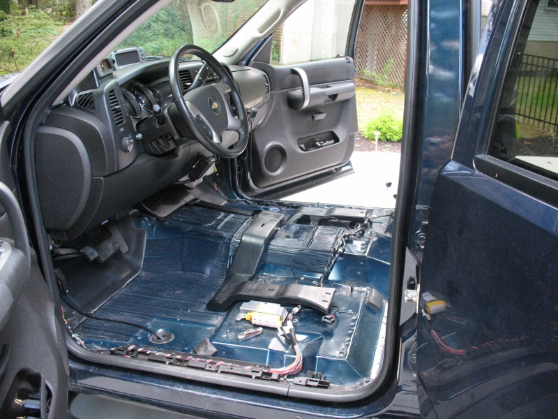

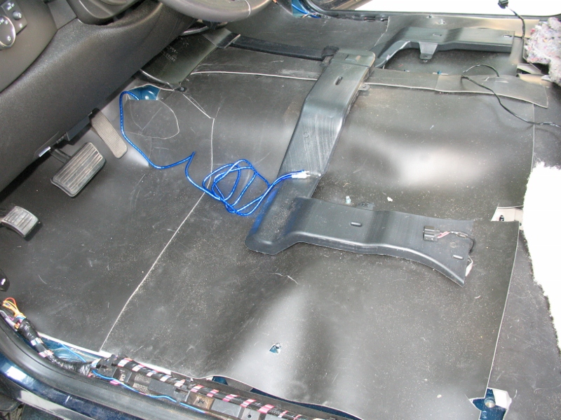

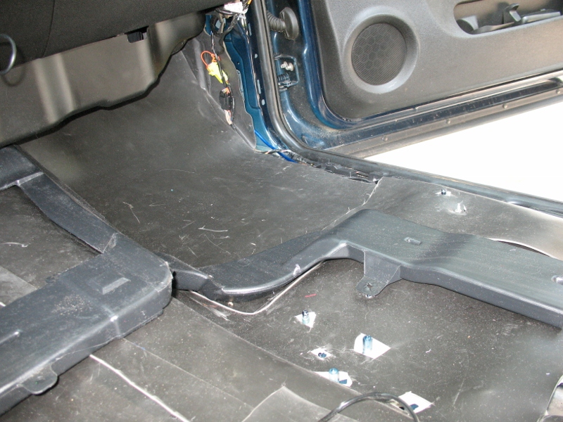

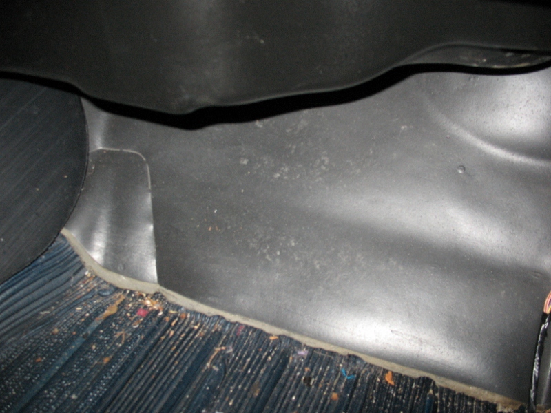

My whole interior is yanked out right now. I CLD tiled the floor and back wall, and did CCF and MLV from the back wall to about the middle of the truckl so far. Today I need to do the rest of the floor and get the interior back in. I was surprised to find the the factory does CCF/MLV from the firewall down to the beginning of the floor! I don't know if that's on all models or just the duramaxes though.

looks like I took the front pic b4 I put the CLD tiles down - oh well.

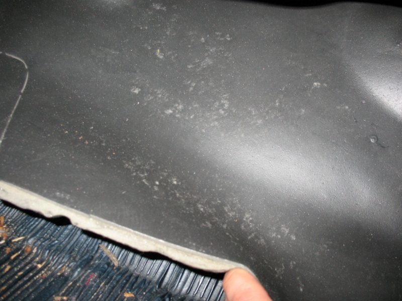

This is the OEM CCF/MLV up front...
ok, I have the interior back in now - yay. I took it for a spin and it's great :-)

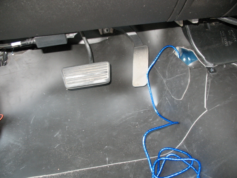

I got the amp in and wired except for the remote wire and the RCA's. I'm waiting on the line converter to show up on Thursday, and I need to find a source for switched 12v.
Getting there!!!

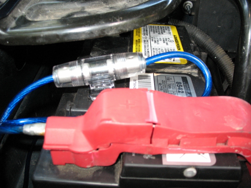

I assume you are planning to mount that fuse wholder to the chasis?
Looking really good.
