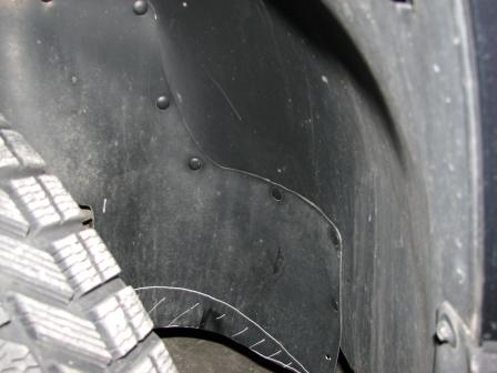

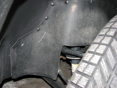

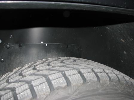

Front Wheel Well Liners Extensions
I made them just before the winter and thank God I did because they worked great keeping the salt spray out of the engine bay area and all the grit and road debris.
post-87526-1300581181_thumb.jpgpost-87526-1300581230_thumb.jpgpost-87526-1300581265_thumb.jpg
Where'd you find those at? :thumbs:
I made them myself, kept the templates also. Just used 1/8 rubber and alot of trimming and patience.
That is a great mod that I would love to do to my truck. Where do you by the 1/8" rubber stock? Thanks.
Nice Idea! Simple and effective, I'll have to look into it as I hate all the salt that gets everywhere. Where did you get the rubber?
Great idea. Do they make any noise in daily driving rubbing on the a-arms? I may have to do something similar to mine just because I like to keep the engine bay as clean as practical and this should help.
I bought the rubber from a local rubber store that specializes in hydralic lines, they also sold rubber sheeting by the foot its the same rubber they use in out door ponds.
Haven't noticed any noise at all, theres a small rub mark on the extension from the tire rubbing it in real tight turning but thats it.
How about the fasteners, what did you use there? Great idea by the way...
The fasteners are plastic barb push-in style there 5/8" long with a 5/8"dia. head.
