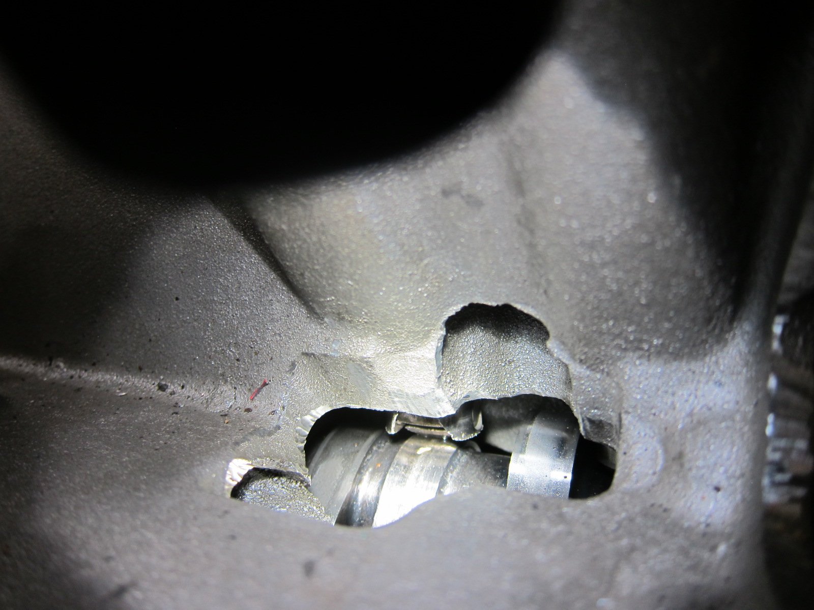

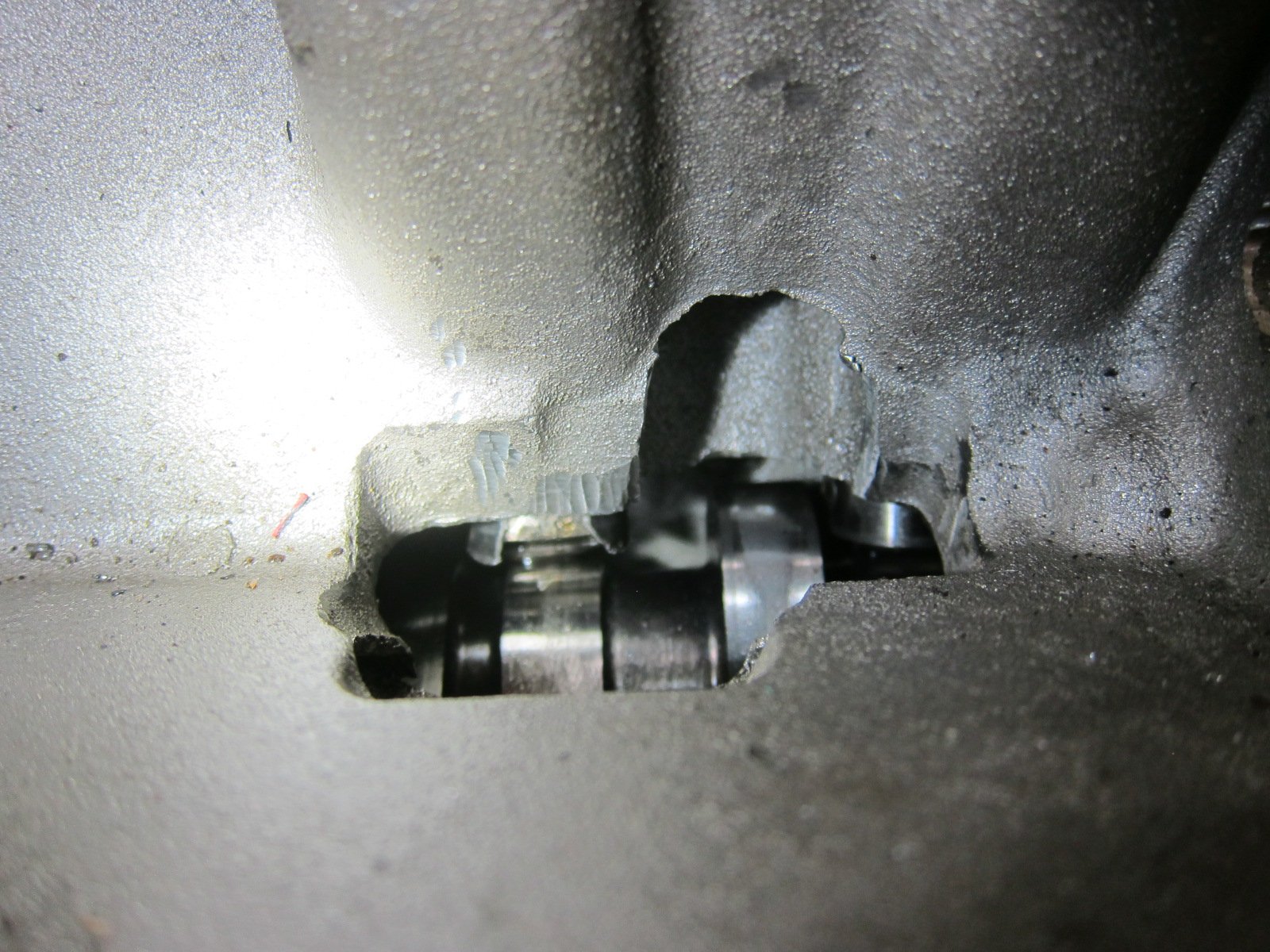

Got my buddy's blown up OE 6.2 out of his '10 Camaro (I can never remember what friggin year this thing is - it's the FIRST year of this style, whenever that was ... '10 or '11). Looks like a lifter is ate up pretty bad. Can't see very good on camera, but the roller wheel is pulverized, and the skirt of the lifter around the roller is blown out on each side. That's what was making all the racket. Since he ran it so many times like this, all that metal is now embedded in EVERY bearing in the engine. Needs a complete overhaul.
We're going to tear this thing down soon to see what kind of damage we've got, besides the windowed lifter and debris in all the bearings. The plan is to rebuilt it, and drop it in a 80's Regal / Grand Prix / Monte Carlo /Cutlass, and make a wheelie-drag vehicle. :thumbs::)

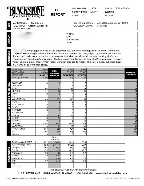

Amsoil is great stuff. When I changed mine at 9,900 that one time, the oil itself was fine, but I had very high levels of wear metals in the oil, so Blackstone suggested changing it at 7k. I've been doing that the past couple changes, and the metal content is a little better. That's all due to this engine, and not the oil, as backed up by the analysis. I'll post a pic of the analysis from that 9,900 mile run below:

This particular analysis was after that longer run (thought it was 9,900 - it's 9,635), but it's in the history on the page there (those 2 prior analysis were on 5w-30 - I switched to 10w-30 to try and save this engine from a short life):
