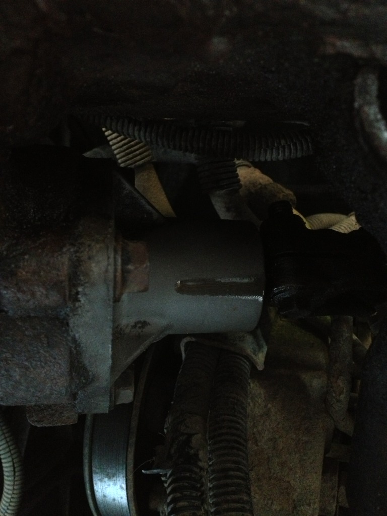

also i have what i believe is a slow drip in power steering fluid.. i havent lost power steering but its leaving some good size puddles in the driveway and all over the differential/cross members etc. could this most likely be a seal or something worse? theres no spraying when i turn the wheel it just looks like a slow leak I did have to add some.

On my 2003 the seal on the pump behind the pulley (shaft seal) leaked for a couple years. I never wanted to change it. Best thing to do is clean up the mess and drive for a bit and check it to try and get a better idea where it comes from. If they make a dye for P/S systems you could try that too.

the leak area is a mess ill clean it up and give that a go, doing the dye is expensive and i dont have access to it so that will be a last resort, being that its so slow im pretty sure its just a seal but i need to be sure, this is something ill probably have a shop do since im not familiar with pumps yet.

The steering leak is the steering shaft seal I cleaned it up today and found the leak
