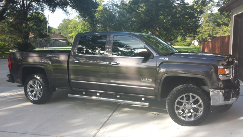

Sorry for the delay. I tried posting last week using the tapatalk app, but it said my pictures were too big. I have since shrunk the photo. Here they are. I must say, what a huge and awesome change. Makes a nice luxury truck (SLT model) feel like a real truck after having the 2" level and new tires.
I had the 2" "Zone" level put on the front. For the tires, I put 285/55/20 BF Goodrich A/T KO2.
Pros
-Truck looks 10x better with the level. (Even with factory tires still on before I put new tired on it looked better)
-New BF Goodrich A/T K02 tires look great on the truck. Not over the top aggressive, but not boring either.
-No rubbing at all.
- Perfect height for what I was looking for.
Cons
-looks about like 1.5-2mpg difference - But I have mostly only driven city miles. With gas $1.80 it's no biggie.
-Noise is not an issue, but the tires are louder than factory. With radio on, you barely can even hear them.
-Slightly rougher ride when going over potholes or traintracks, but not much difference at all.
Overall, without a doubt I'd do this same setup again. It's not too high, not too big tires, just perfect for what I was looking for. I didn't even tell my wife I was doing it. She even said, "Man look at those tires, that looks really good...." she doesn't even pay much attention to my vehicle either. So she noticed. :)
Here is very similar picture as posted before.
I really should do a straight shot vs the angle shot with tire turned. This was just how I had it in the driveway when I decided to take the picture.
