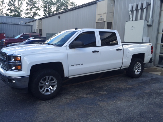

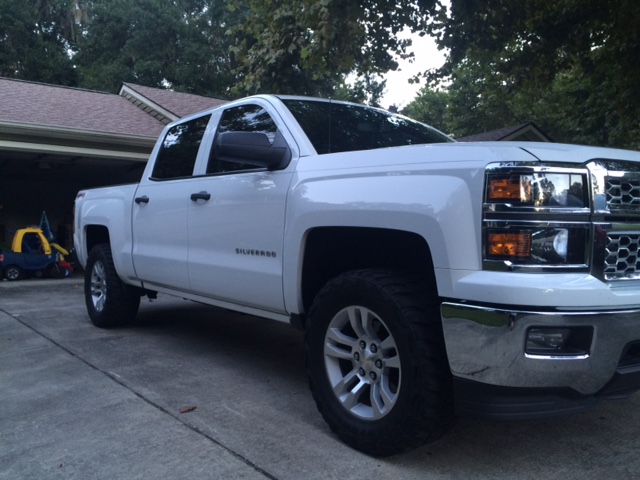

I have been running 33x12.50s on mine for 50k mile now. put the 2" level and tires on when it had 900 miles. At full lock it will slightly rub the swaybar. I just ordered a set of 305/65r18 nitto G2s so we will see, but I anticipate the same results.
BTW... using the factory 18" wheels
You can't make this first post without pictures!! :nonod:33x12.50 on stocker 18s??!! Lots of us would like to see those pics. Post 'em up.
You can't make this first post without pictures!! :nonod: 33x12.50 on stocker 18s??!! Lots of us would like to see those pics. Post 'em up.
Still waiting! No pics.
I can't quite figure out how to post the pics. It says the file size is too large???

Nice. Thanks for pictures. What brand tires are they? What's your lock-to-lock rubbing when you hold it against the stop look like?
