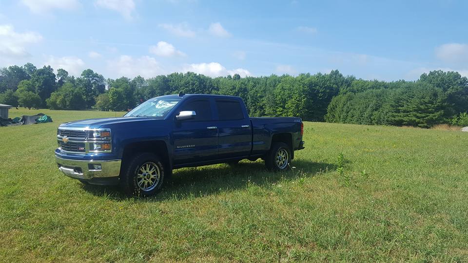

Here's my '15 2.5 rc with 3" rear block. 275-70-18
What rear block do you have, the RC 3 inch? Did you get longer rear shocks or shock extenders?
Looks good.

I have 3 inch front and 3 inch blocks in the rear. Its good insurance to get the shock extenders. Get the readylift extenders. They have a sleeve in them to keep the bracket from being crushed when tightening it up. I didnt do a diff drop on the front. I'm sure the 1 inch spacers rc sells I could do just don't know if any grinding off the case would be needed. As is now she rides just like stock but looks a crsp ton better
