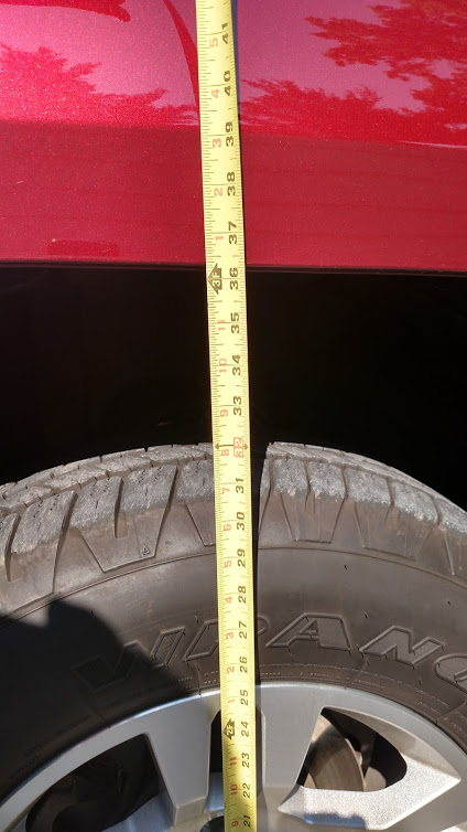

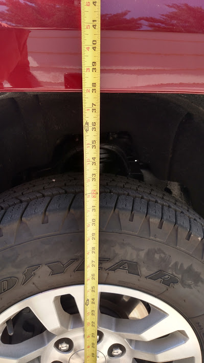

Just installed the MotoFab 1.5" leveling kit on mine. First side took me 2 hours, 2nd side took 30 minutes. Glad I did it. Closer to level, but I don't mind a little rake. Rear is 39.25". Front measurements below, and side view w/ the 1.5" kit installed.
