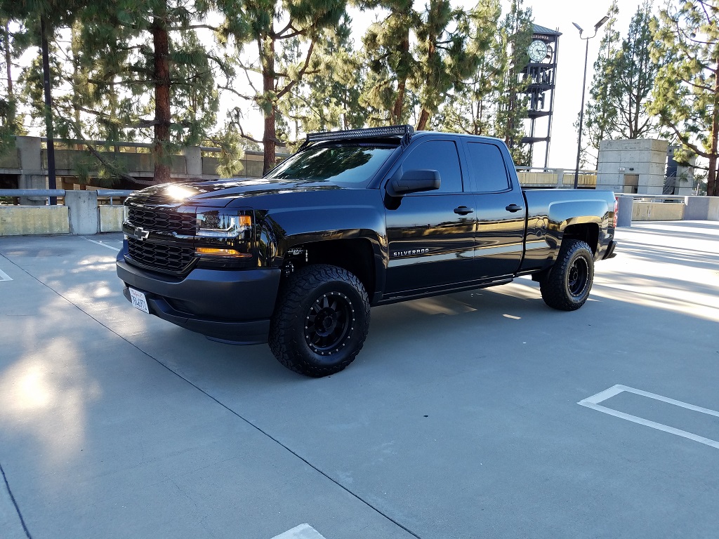

2 level. 275/60/20 bfg ko2. Fuel coupler gloss black.

Stock w/ 275/65/20 KO'2s. Running at 35psi
Your harsh ride is because of the LT tire not the level. 10 ply tire rides rough compared to stock tires. See a lot of guys thinking the rougher ride is due to the level and not the LT tires they just added too.
Agree and disagree, my truck rode much stiffer with the 2.5" RC and stock SRA tires than it does now with my 6" lift with 35" MT tires.
I disagree with your tire theory. It had a 2" level with no added block and rode great......... But thanks anyway.

RC 2.5 with rear block went on today along with new wheels.
Moto Metal 20x9 MO970 Black/Machined 0 offset
Toyo Open Country ATII 295/55/R20
I noticed a slight rub in reverse on the mud flaps but when I got home and looked while my sister steered the truck in reverse, it seems to barely clear... I mean you could barely fit a hair between the tire and the flap. Might have to do some trimming but I couldn't be happier with how everything turned out!
Good looking truck! Did you remove the stock rear block? I have 2.5" level in front and ride about 1" high without a trailer load. I want to add a rear block.
Thanks!
Looks? Can easily tell it is. Never seen a stock truck with 3.5" of stock rake (2014+ half tons). What was the stock fender measurements and what are they now? I am guessing about an inch nose high? Mine had 2 inch stock rake, most have 2-205" stock rake.
Should add a 2 inch rear block to give it a level stance and get your headlights closer to correct.
Tyler
Mine sits about a 1" high in front with 2.5" up front and nothing done to the rear. Should I remove the rear stock block and add the 2" block to give it more level look? Will that help?

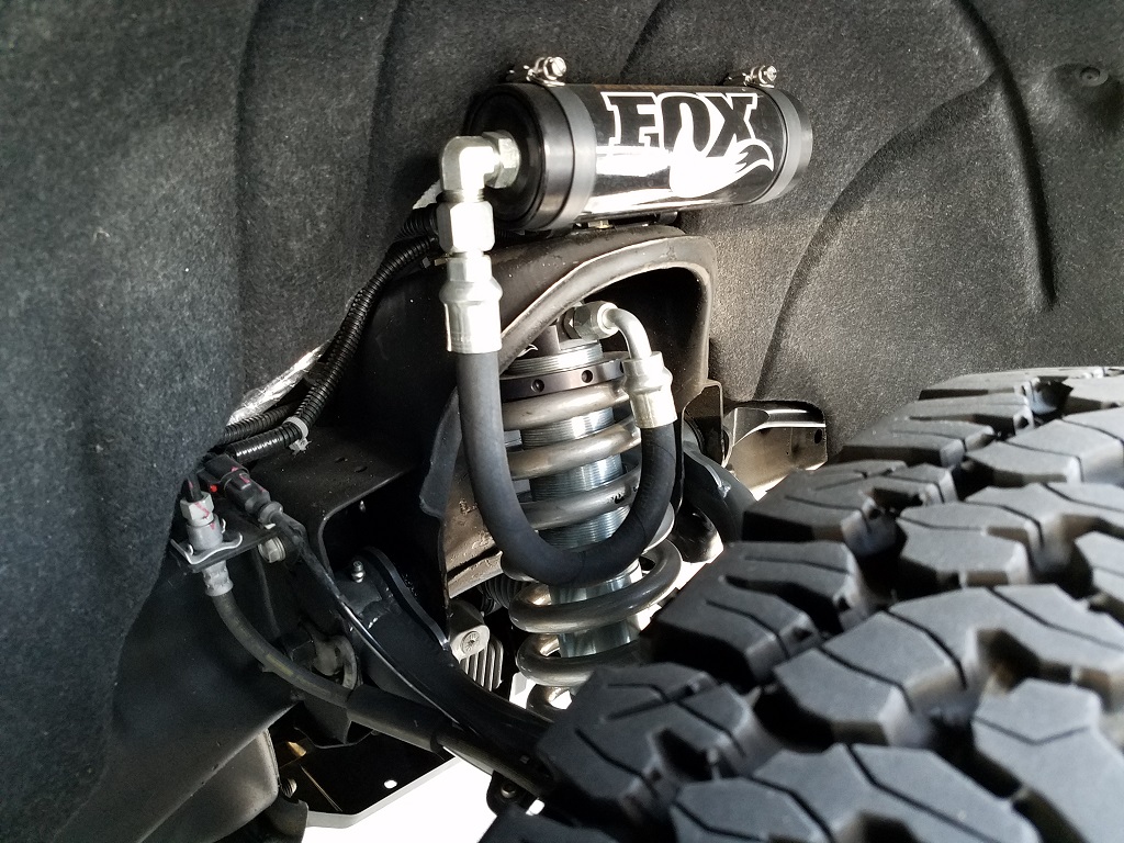

I spent countless hours on the forums and looking at available kits. I wanted something that did not change highway ride quality and also improved off road capability. I ended up going with Camburg's 2.5 coilover kit. I absolutely love this kit, it drives great on road and amazing off road. .

I spent countless hours on the forums and looking at available kits. I wanted something that did not change ride performance and also improved off road capability. I ended up going with Camburg's 2.5 coilover kit. I absolutely love this kit, it drives great on road and amazing off road. .
https://camburg.com/shop/suspension/fox-chevy-1500-2wd-4wd-07-14-factory-2-5-kit/
That looks like a sick leveling kit ! Just pricey
