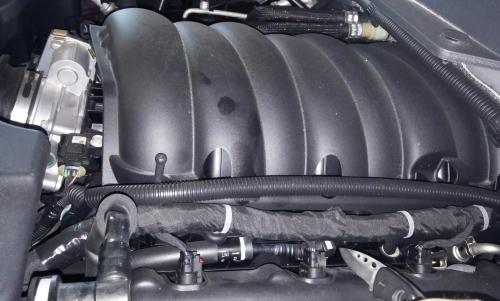

I got my cc a few days ago. Hopefully installing it today. Sounds simple enough from what you guys are saying. What all have you guys been having to remove to get to the ports? I have a 2014 5.3. Looks like its a pretty tight space along the drivers side of the engine where the port is. Wiring harness and hose tied pretty tight along there. That back port is where my knife is pointing correct? Did you guys need to disconnect other stuff to get to it or remove all the plastic pieces covering everything?
Just press that grey retainer clip on the fitting and pull back on it and follow the routing of the hose and remove from the PCV port on the front of the engine under the Throttle body.You might have to move the injector harness a bit but not much.
