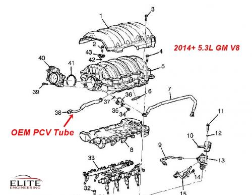

Think I've got it figured out if I'm wrong can someone please correct me on the 14 5.3 there is a connector on the driver side half way down the intake and one just below the throttle body I take the first hose from side of intake connect to inlet on catch can and the exit of catch can to bottom of throttle body! Is this the correct hose route?
I think you are thinking backwards just like I did. Exit of the can goes to the drivers side. Take a look at chevy2tuff2006's post #622. He explains it pretty well.

Got any pics so I can see how you hooked the hoses up and where?
Here are some diagrams from GM
