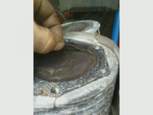

An interesting carbon story ...
I had someone bring me a generator they thought was seized one time. I could rotate the engine 350° in each direction, but it would not reach TDC. I figured someone dropped something in the combustion chamber when they had the plug out. Was a side valve, so no chance of a valve dropping inside. When I got the head off, I found deposits all the way around the edge of the piston crown nearly 1/4" thick! First time I'd ever seen that happen. Guess the guy rarely ran it, and when he did, it ran on stale, cheap fuel.
Lesson learned!
