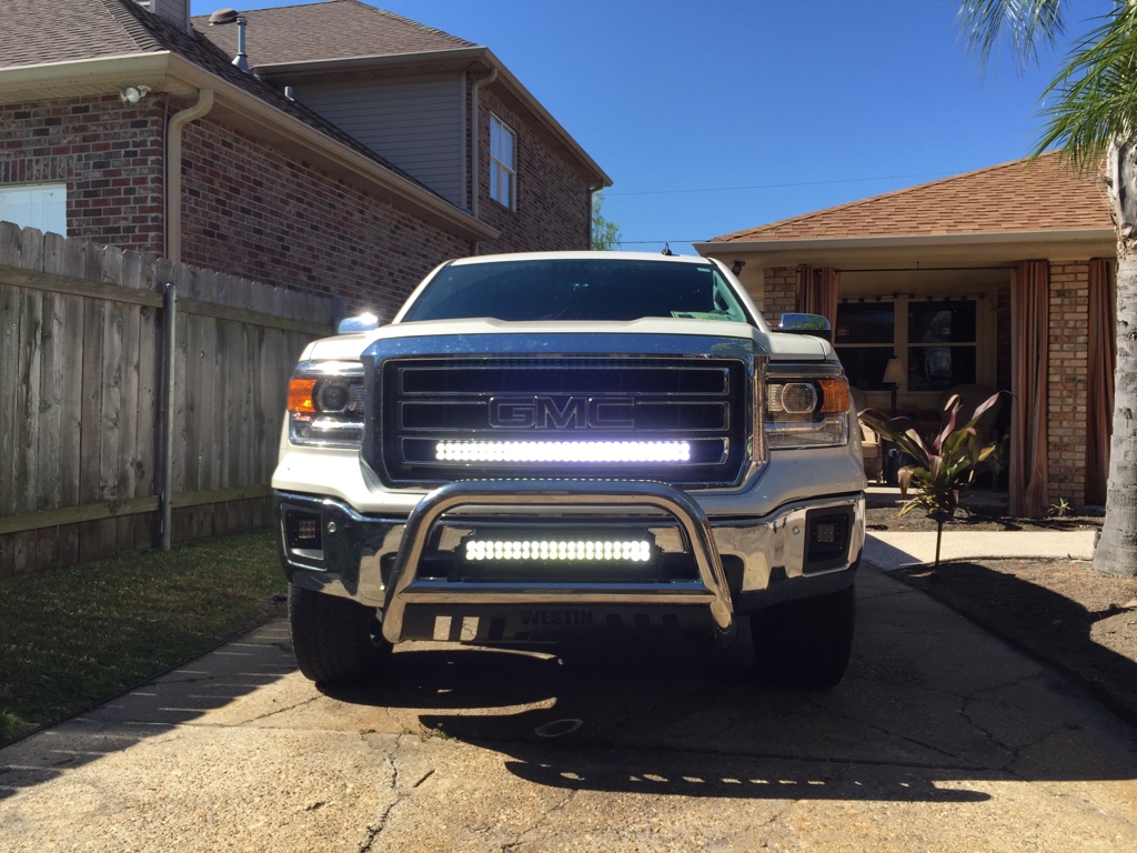

How do you have the light bar in the grill mounted?
A bit more info on the bar here:
http://www.gm-trucks.com/forums/index.php?/topic/155567-LED-Front-Light-Bars-%26-Pods
As for mounting, I went ahead an used 3M double sided stick tape to stick some 1/8" thick x 2" aluminum to the radiator support struts until I found where the light bar would shine perfectly through the grille. After that I went ahead and just drilled 4 small holes through the aluminum and radiator supports and put bolts through with nuts on the back end to hold everything in place. Will see how well it does in the long run but it seemed to be holding nice and strong when I tried messing with it after I finished installing

Nice, thank you man. :thumbs:

Thank you I'm sure lots of people will benefit from that!! Using that tape is a great idea for finding the best location, I don't think I would have thought of that.
I use that tape for a lot of things. They sell it at Home Depot by the rest of the tape. I get the big role. I can't remember the amount you get but its 1" wide and holds 10 lbs per square 1". It is also rated for outdoors. It's like $15. Incredible deal for what it is.
