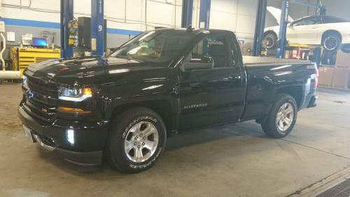

My Belltech 7" flip, stock hanger w/shorter shackle (as pictured above) gave me about 7 3/8" drop.
What does it measure from the center of the wheel hub? Measuring from the ground will change results because of tire height and Im curious how mine compares. Mine is 34" from ground, but I'm on a 285/50R20

I dunno. Mine def doesnt look 7"
What year is yours?

Yea, those photos were from when I first lowered it while on the stock 17's.
I'll measure from wheel center and get back to you.

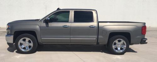

Dropped mine today with the Belltech shocks and Shackles. I was able to easily get the alignment within specs.
More pics in my Build thread
Before:
After:
Shocks don't affect alignment. So I'm not sure what you mean
Well, front strut is a lowering mechanism.
Using lowering shocks throws the camber and toe way out. My camber was at -1.9 degrees on both side and the wheels toed out big time with the drop shocks.
