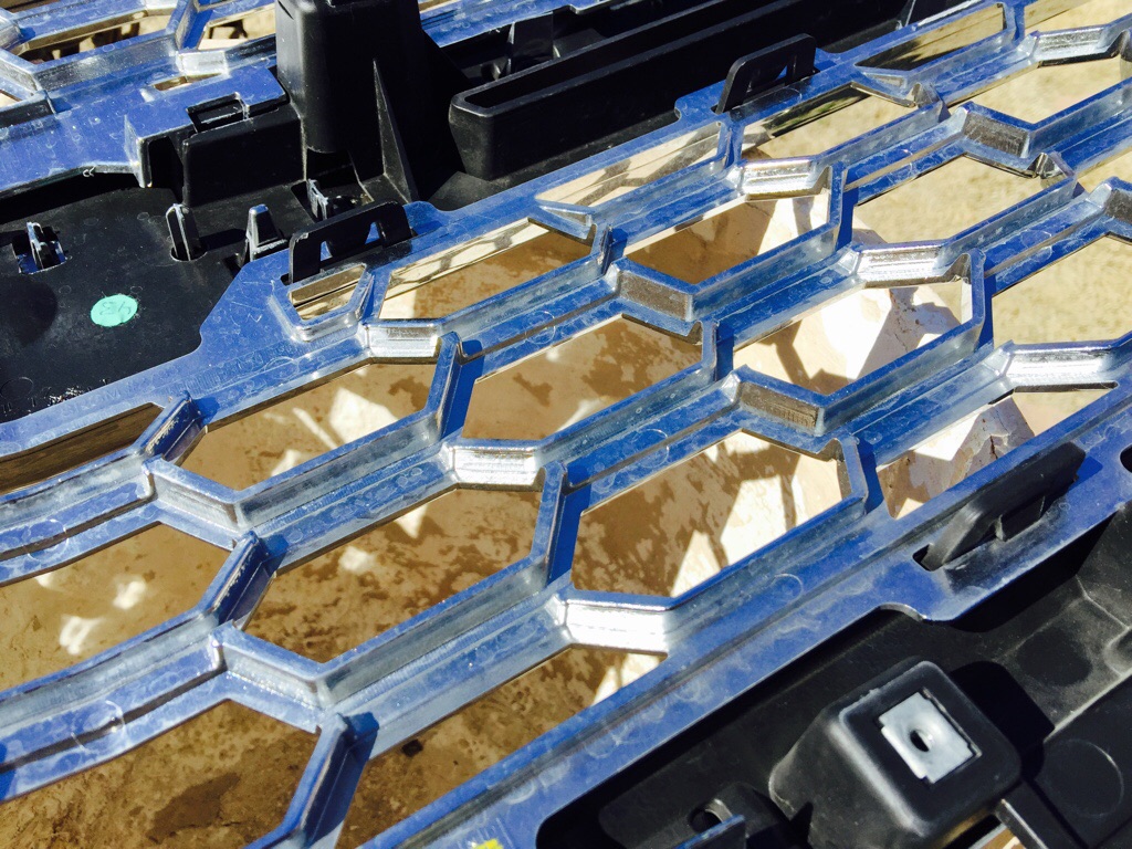

The inserts look like they can easily removed. But you would probably need a special tool to keep from breaking the lock tabs. In fact the entire chrome surround looks like it could be popped off.

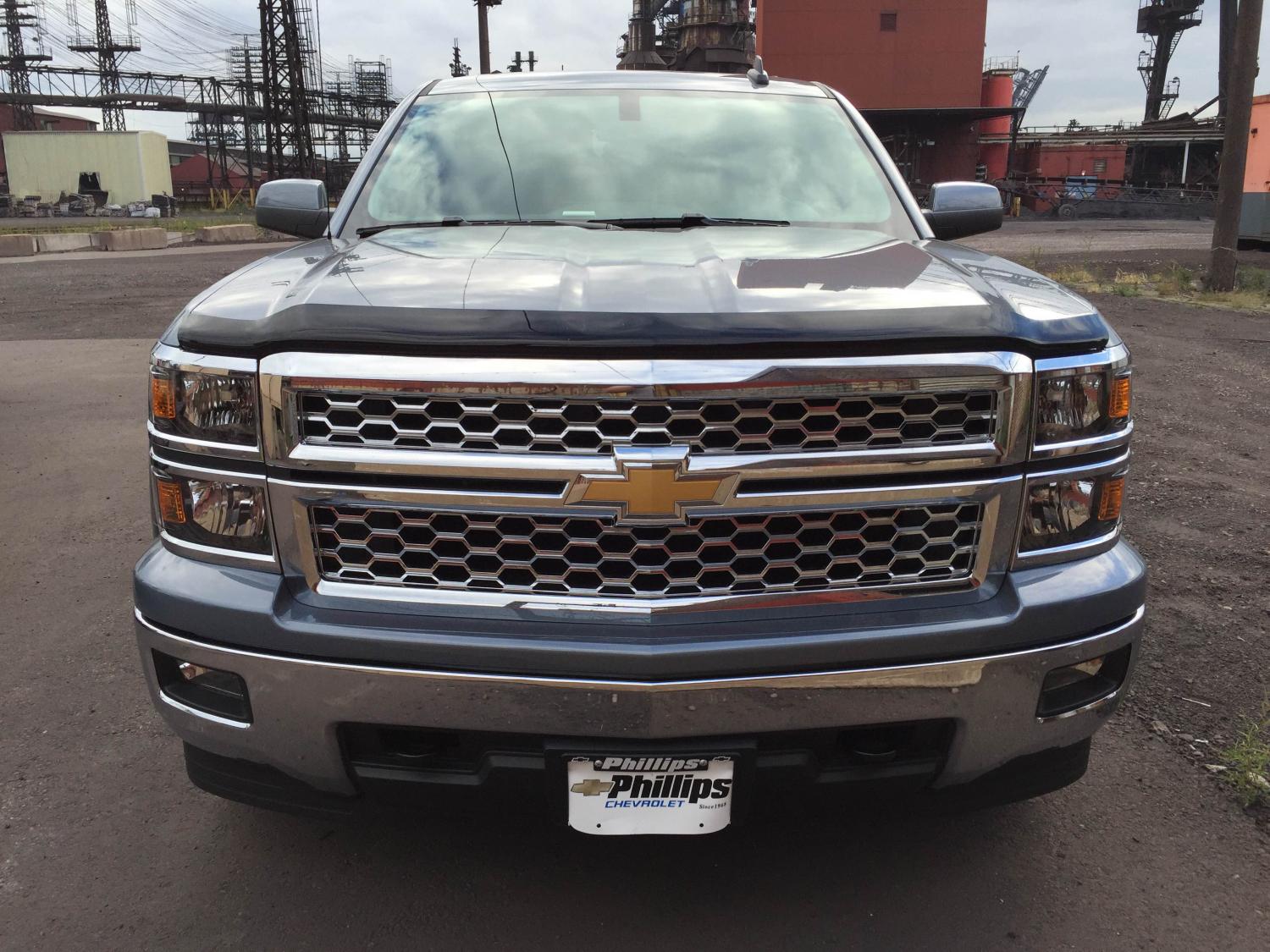

Thanks for the pics. Is yours a 2014? What exact model? And if you're comfortable what's the last 8 of the VIN? I may have to resort to ordering that exact grill to get mine to fit.
Cheers
Thanks for responding so quick.
Were the inserts changeable only on the aftermarket one you installed? Or on the OEM grill too?
PS. Did you trade the truck for something else?
My original was an OEM full chrome just like in the pictures above. I purchased an OEM one with the black inserts instead, and just swapped the entire grille. Both of the OEM grills did have that same clip style to remove the inserts.
I traded the truck in for a F150, I had issues with vibrations that couldn't be resolved.
Mine is a 2014 Regular Cab LT. I replaced the entire grill with the one with black honey comb inserts. It was configured the same way. I got it from a member here.
