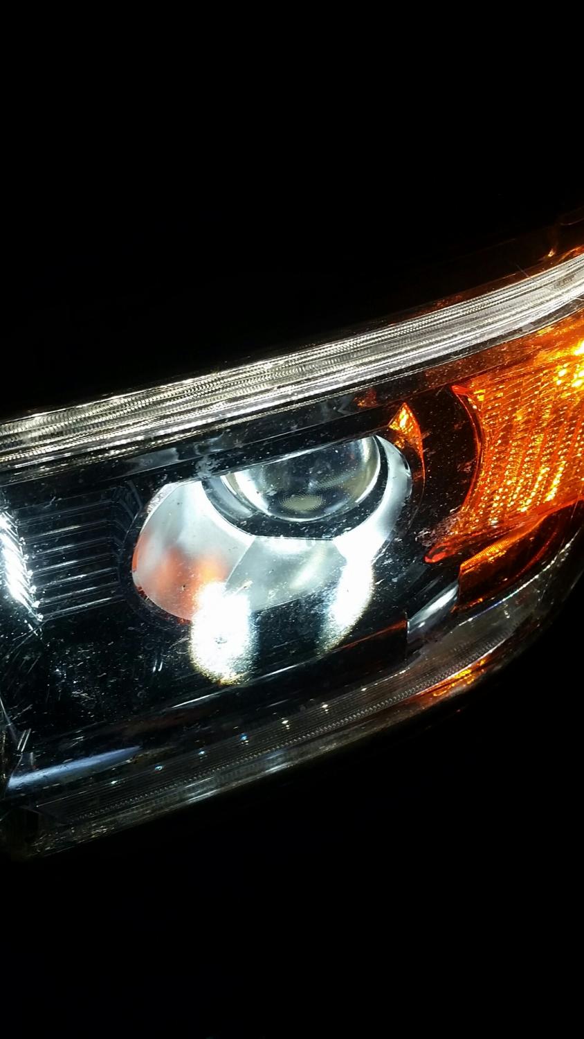

Is this how the diode split looks like on all you guys that installed the xenon depot LEDS?
That's pretty much exactly what mine looks like.
Alright good to know. I think they are better than stock for sure, however my highbeams don't seem to really add much for distance and just a hair more spread. These lights are rated at 2400-2500 Lumens according to xenon depot's site.

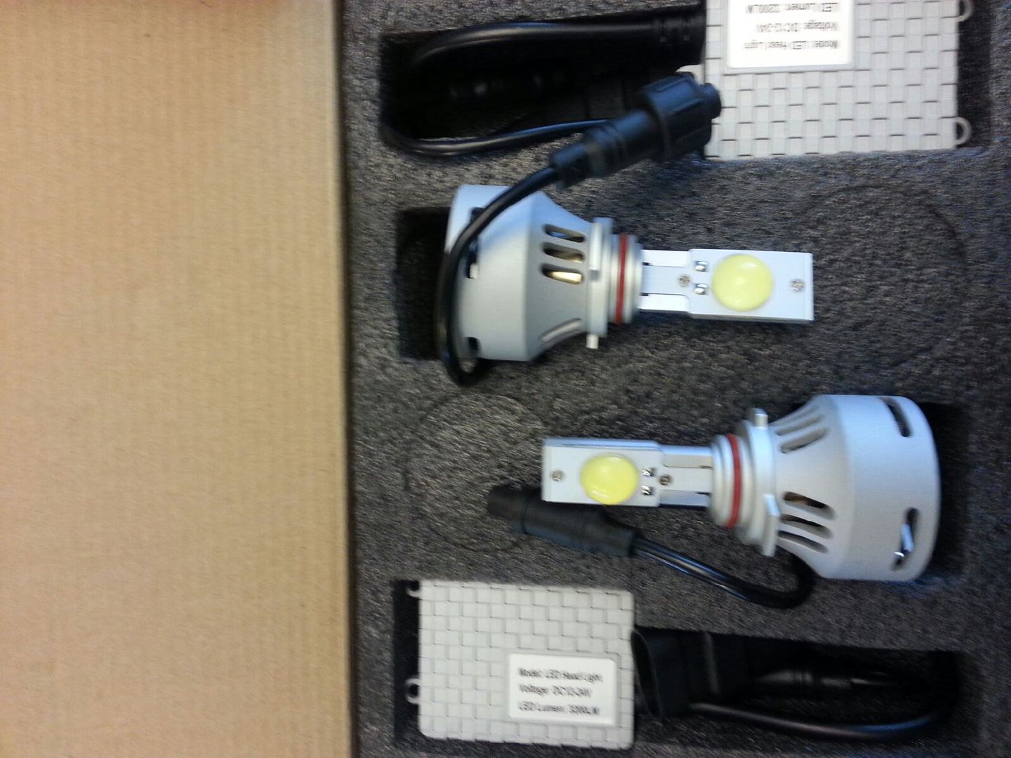

I recently found a more local (2 hours away) private dealer that sells 9012 led headlights as well, only those are rated at 3200 lumens and are the ones with a fan (still skeptical about fans). He offered to let me try them at no charge so I thought why not. Should have them tomorrow.
Here's them attached. The diodes also look larger (assuming those yellow bubbles are them) as well compared to XD's as well, which are smaller and square shaped.
