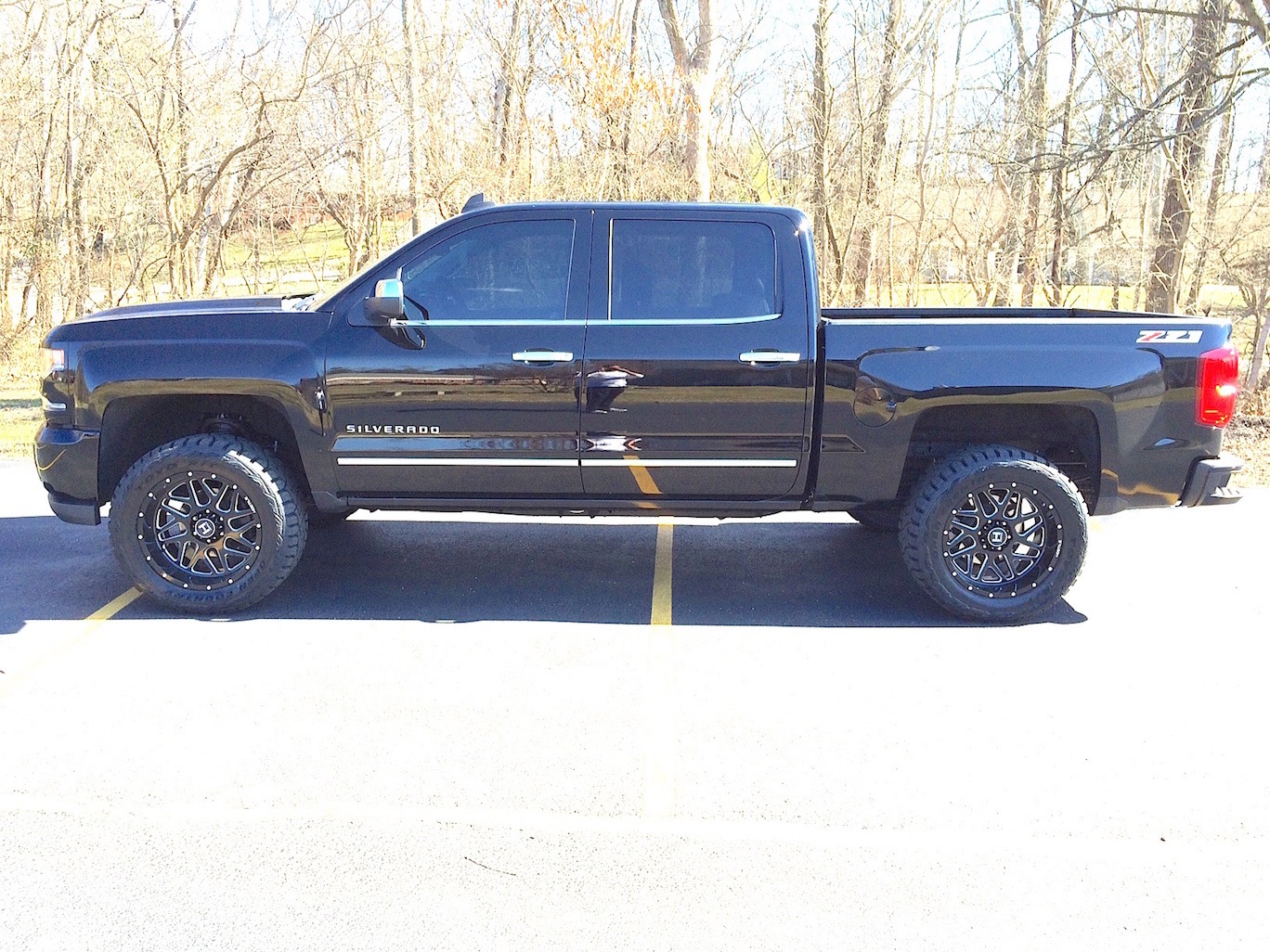

I didn't add all these today, but over the past 4 months I have added : tinted windows and front windshield, leveled, spray in bed liner, Morimoto HID's, Rigid DOT approved cubes, fogs w/ high beam mod, LED reverse - cargo - tag lights, Airaid MIT, GM Borla cat back - dual side exit, in-channel vent shades, Permafinish and today - Full Kicker Soungate upgrade. I am really digging my truck....
Looks great! How does it sound? Can we see some pics of the whole truck? From what I can see those helos look awesome
Sent from my Nexus 6 using Tapatalk
The sound is really good. Nice rumble on acceleration but very quiet on the highway. I'll try to post a video tomorrow if I can. The wheels are Hostile sprockets, my first time with black wheels. I get a lot of comments on them. Thanks. I have more pictures posted in the wheels and tires section.

Truck looks great! I'm looking for this exact stance or something similar..... Would you mind sharing your wheel tire and leveling kit specs? Any rubbing at full lock or suspension travel? How much if any trimming involved? Everything I'm reading is to go with a 0 offset on these trucks with just a level kit.
Thanks. The wheels are 20x10 with -19 offset. Tires are 33x12.50 Toyo open country R/T. I did not have to do any trimming but did do the zip ties on the wheel well liner. I've heard it rub in reverse twice, and that was on coming out of my driveway which is a little steep. Other than that, no rubbing. The level is a rough country 2.5" in the front and the 2" block replacing the stock 1" in the back.
