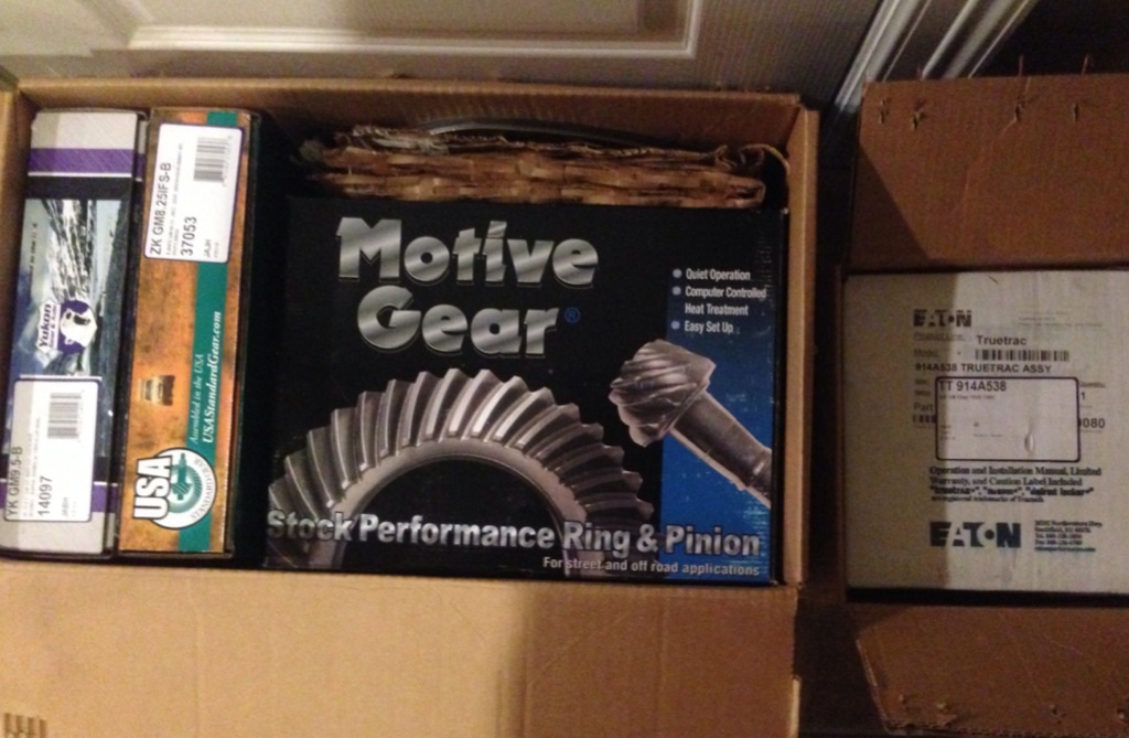

Gear Change 9.5" 12 bolt
CAtaylor
This box of goodies just arrived. Will let y'all know how it turns out in a couple of days. The Tru-trac and rear gears are for the 2013 9.5" 14 bolt, i have a spacer for the diff cover and conversion u-joint to make it all go back together in the new 12 bolt, 4.56's for the front as well.
