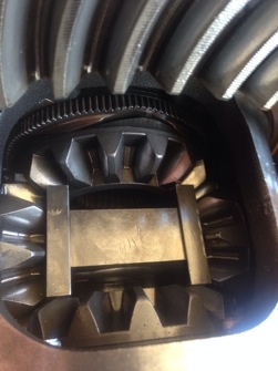

What is the rear locker in these new trucks? is it the same as the old G80?
No
No
Is it also different from the "smaller" axle to the "bigger" axle? I'm just wondering what my all terrain has in it.
I have tried finding details on the factory unit. All i can find is it has been improved and has a quicker lock up time. I haven't been able to find any specifics though. Appears to just be an "improved" G-80, mine is at the shop now as well hopefully i can get some pics of it in a few days.

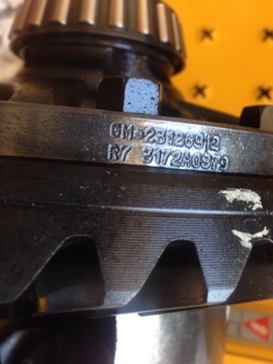

Here are some pics of the factory locker. I can't see any changes from the old G-80 just looking at it but i have only seen one other in person. Also the motive gears have quitened down after about 50 more miles, 2-25 mile heat cycles. Can't hear them listening for it now.
