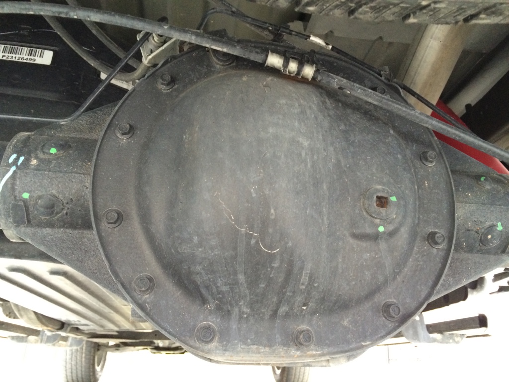

fataslp Posted December 12, 2014 Posted December 12, 2014 The lower two are a 9.5 while the 3.73 is a 9.75 I believe. Here is my 3.08 and 12 bolt.
fataslp Posted December 12, 2014 Posted December 12, 2014 do the green marks on my diff cover mean that someone has been in there since they are not aligned?
hemipowered22z Posted December 12, 2014 Posted December 12, 2014 The lower two are a 9.5 while the 3.73 is a 9.75 I believe. Here is my 3.08 and 12 bolt. ImageUploadedByTapatalk1418405007.639066.jpg Thanks for the clarification. I definatly misunderstood
