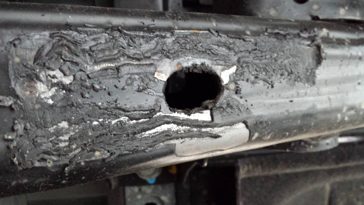

I just received my 2014 SLT Crew Cab that I had ordered on February 15th. Naturally, one of the first things I did was check the wax coating on the frame. There is one spot where it looks like it has smeared or came in contact with something – possibly during the build process. Other than that, there are certain areas (IE: sharp edges or irregular surfaces) where the coating is very thin or not on at all. If my truck wasn’t leased, I’d be inclined to fix this myself. I’ll let the dealership deal with this though. After crawling underneath, and going over every corner of the frame, I am skeptical of this coating holding up under certain conditions (IE: gravel roads, Canadian winters). I'm a bit disappointed to experience this after spending $50,000 on this vehicle. This is frustrating as I had wanted something I could keep for 10 years but am not sure now. Just how serious of an issue could this become down the line? Personally, I really don’t know how this is fixable other than just redoing the entire frame. Thankfully, I have the option of just returning this after the lease is up…

Holly Molly, that's bad. Get that over to the dealership ASAP, I know where you're coming from I'm in Winnipeg.
WTF, HOW DID THIS PASS INSPECTION?

In your second picture right where you see that bolt head on the underside of the frame, to the left of the bolt was a problem area on my truck on both sides. It was as if there was painters tape there when they dipped the frame and then it peeled off and rusted. Can you see that spot on your frame and verify what it looks like? It looks like it's pealed slightly at the edge before the frame turns vertical facing the camera and that's what mine looks like. Sorry I don't mean to point something out that might bother you but just wanted to see why I had identical rust spots on both sides of the truck in the same location under the frame.
Its all smashed up and metal slightly exposed but sprayed over with the clear. No rust. I'm going to take some black spray paint and touch it up now lol. I bet its from when they stack them after the dipping process.
