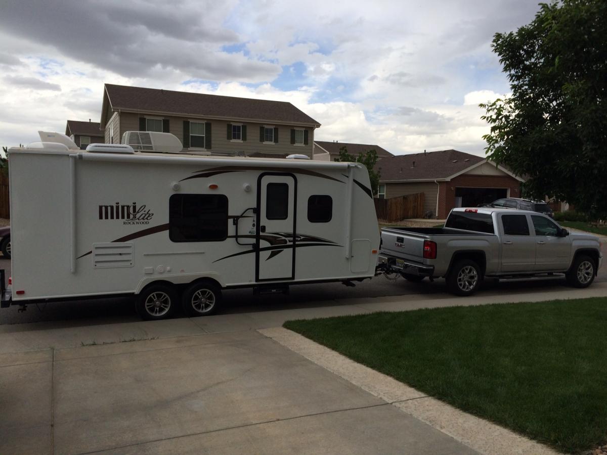

2014 Sierra SLT 4x4 (3.42 rear) towing 2015 Forest River Mini Lite 2306 model dry weight 3,800 lbs can hold max weight of 4,800 lbs. Did my first trip up the "GAUNTLET" Denver Colorado to Eagle Colorado through the I-70 pass. The truck did struggle on steeper hills but it did get the job done my trailer probably weighed in around 4,200 lbs with all the gear I had. From Denver to Eagle averaged 9.5 MPG on the way back from Eagle to Denver averaged 12.3 MPG. This was mainly due to the steep grades between the two directions not much wind played a role in this. Braking was great and handling was great due to E2 equilizer hitch. Overall very happy so far with the performance of the truck.
