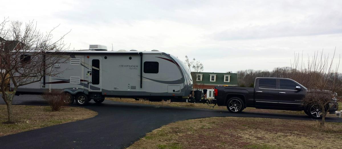

I pulled my TT for the first time this weekend. My truck managed the short 50 mile trip perfectly. Spec's on the TT are 36' 6" long and weighing in about 8800 lbs loaded. Overall... I am a very happy camper with my setup!!! LOL 5.3 with 3.42

So the manufacturer of my TT is Cruiser RVs. The model is VIEWFINDER Signature 32KIBH. Dry weight is 7830 with a tongue weight of 810 lbs. I purchased the TT from Holman RV in Ohio. First class outfit!! So from what I can gather, they made my model TT for 3 years, that being 12,13 and 14. I believe they changed the model late in 14 to what you are looking at. This is my first TT and I am very pleased with it.
The WDH I use is the Equal-i-zer with built in 4 point sway control (awesome system). I have had the truck up to around 65mph towing with very little sway at that speed. I have not done any mods for towing as of yet. All though, I have been kicking around the idea of installing the Timbren Rear Suspension Enhancement System. A friend of mine has them installed on his new F250 and really likes them. I am still not 100% sure I need them.
