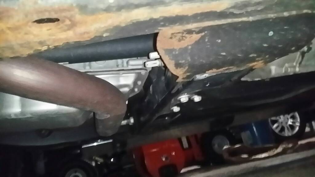

Do you guys think this rust is bad enough to address with my dealer? On the fence about it.
I'll tell ya on Friday when mine goes in. I should takes pic too of it. It's similar to yours.

Yes let me know! I'm going to at least bring it up when I'm in for my oil change in May. Get in on record in case it gets bad. The 2014/2015 I saw today had rust in the same areas but 10x worse.
There are some members here who had rust like the truck was sitting in the ocean floor bed. Mine never got so bad. One thing you want to check because I looked when I was taking pictures as proof. check the area around where they put the bars to raise your truck to do the oil change or inspection. I found those areas the wax was completely removed and rust taken hold. Very shocked by that.

This is what mine looks like directly underneath the truck.

What year and how many miles?
2014 with 14250 miles on it. Drive it on trips and only on the weekends. Rest of the time it sits inside the garage. I baby this thing and it got to this level.
