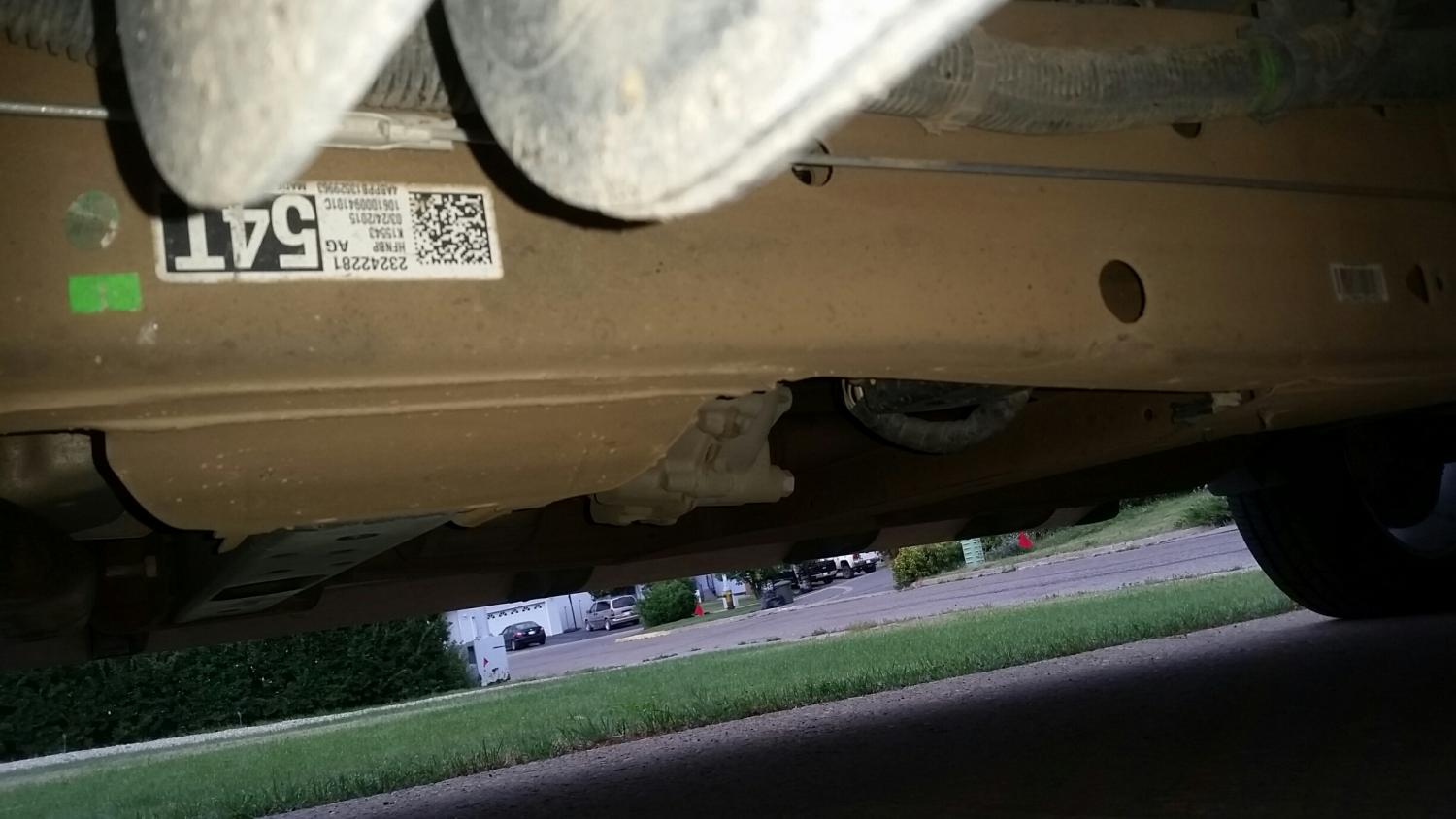

I had a look undermine quickly this morning, I cannot see any spots that are peeling off, and this was right after an undercarriage wash. Dust/dirt just sticks to this wax like nothing so it still looks half assed dirty.

Bear in mind this is all dust stuck to the wax, and I cannot really see if there are any spots peeling.
Truck is currently at 6000 miles, have been on a few gravel roads.
