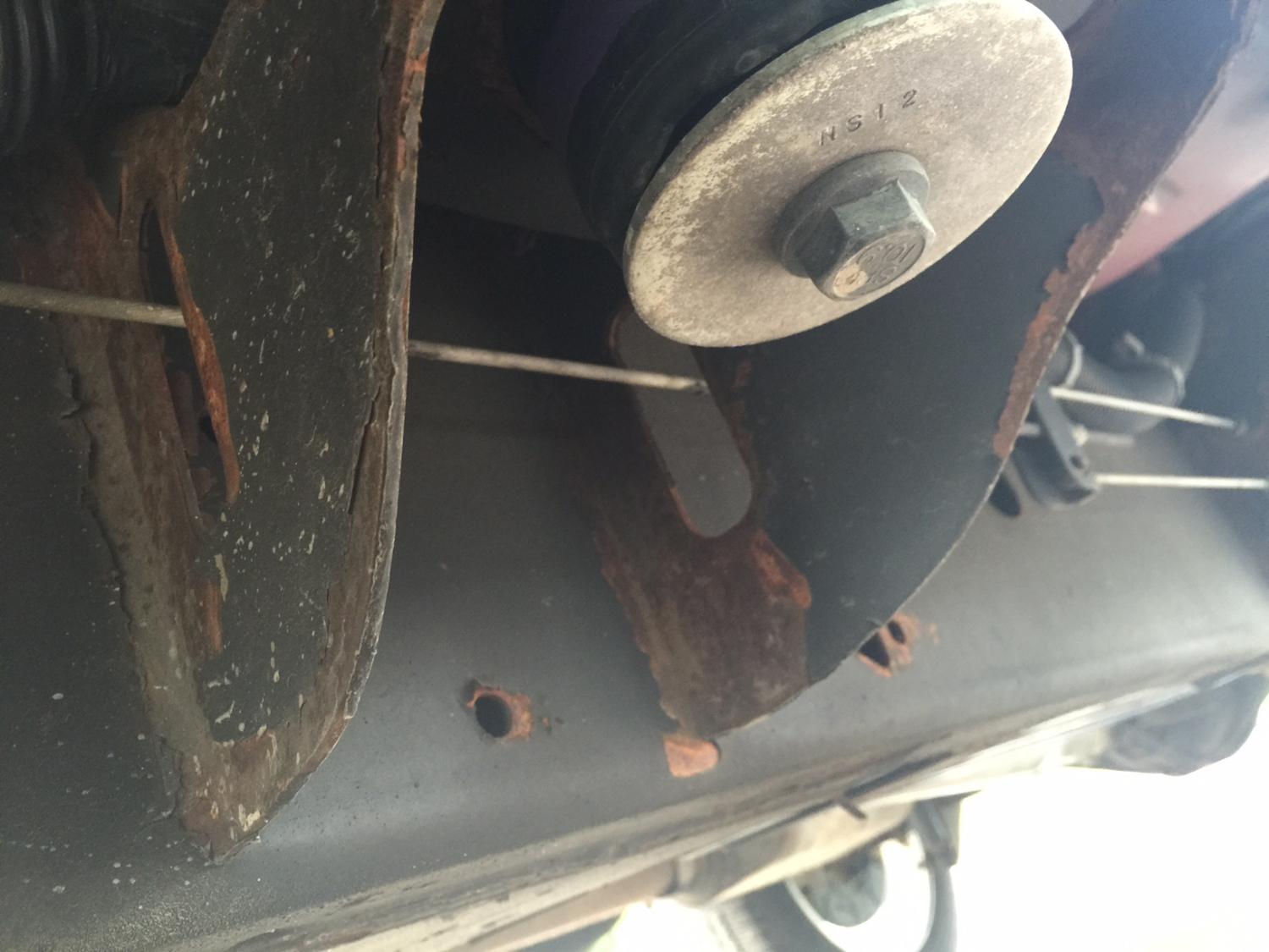

Spoke next with Service dept. to ask for frame rust inspection as truck is 2014 with 25,000km. They suggested speaking to Body Shop dept. who said they just received an email today regarding this issue and from the basic summary they(Mechanical shop) are instructed to pressure wash underside and reapply coating where missing. Not the answer I was looking for, but better than "that's normal". Appointment in 2 weeks and truck required for 1-2days. I will make larger bold instruction sheet not to go willy nilly spraying touch up underneath over everything else and my original natural/white painted underside.
Here are recent underside pics:
After a bit of cleanup for hitch install:
As you can see, you would swear this thing has been commercially used. But if you look at the other body panels it's all mint. This thing moves once every 2 weeks, barely seen winter and 99% paved long haul highway.
I will update later with build date code and AC Delco spray (its messy as he!!, especially upside down), should have worn gloves and full suit and mask as it does not come off.
Honestly, I'd apply a rust converter to stop what rust you have, remove the flaky bits of wax, paint it black again, and coat it with Fluid Film.
AC Delco waxes and rubberized coatings are garbage. Just google it a bit and you'll realize just how worthless this approach is. You'll exacerbate your problem and flush money down the drain. There's no random pattern of GM trucks that have crap undercoating. There's just trucks that have had the junk undercoating fail and there's GM trucks that will soon have the undercoating fail.

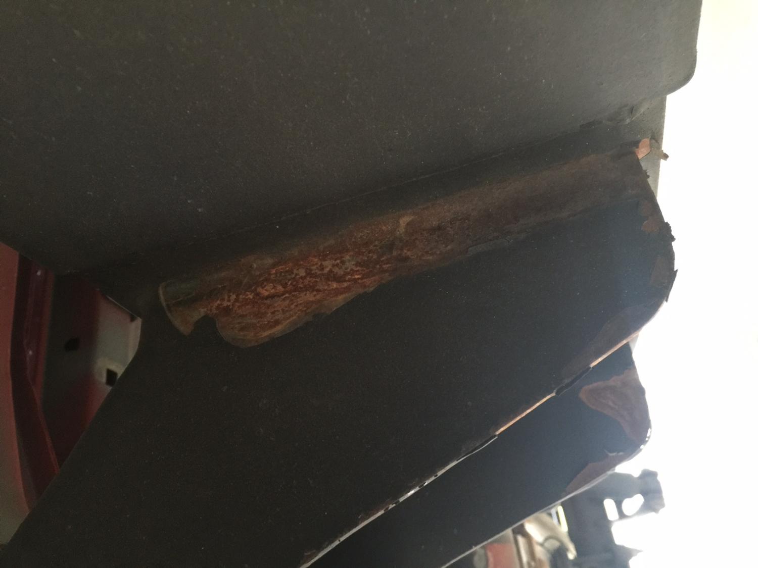

Yup. My frame is showing way more rust and peeling than I feel it should after only one Michigan winter, always being washed and in a heated garage at night......here's a couple photos. 2014 Silverado Double Cab.

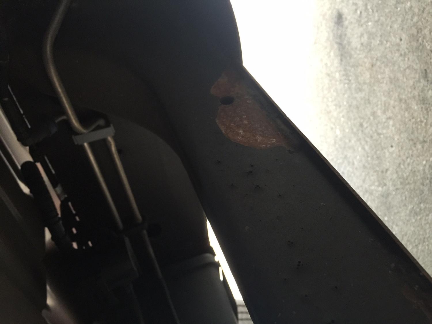

Mine was built in April 2015 and I took delivery in May 2015. It's now just a few months later and that wax coating is falling off and I have rust spots in places. Obviously there hasn't been any salt in MI during the last few months... I think I am going to talk to Ziebart to figure out exactly how their process works and what their warranties are (if any?). This is messed up.

Can you take pictures of where it's coming off? Mine was built the exact same time as yours, haven't noticed the obvious spots yet. I'll take look right underneath later on today.
I talked to a rep from Krown who also does oil spray in Canada, they stated that spraying over the wax will actually speed up the deterioration which leaves me stumped on which way to go before the snow and salt flies.
