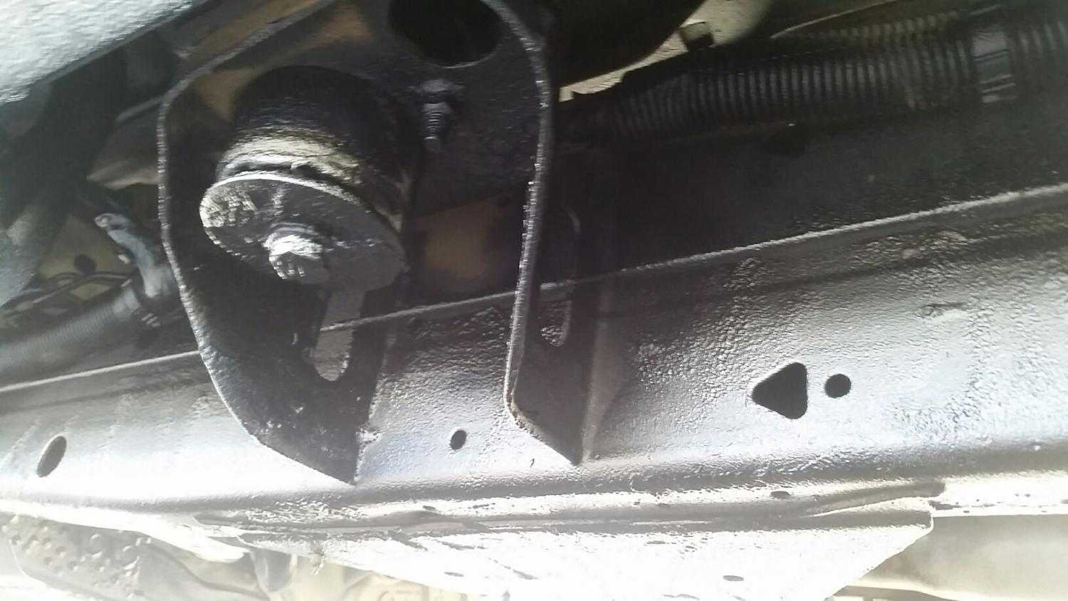

I had a product called "Armaguard" done on my frame and I fluid filmed the rest. Basically a rubberized bed liner type coating but slightly softer.
Attached pictures.
