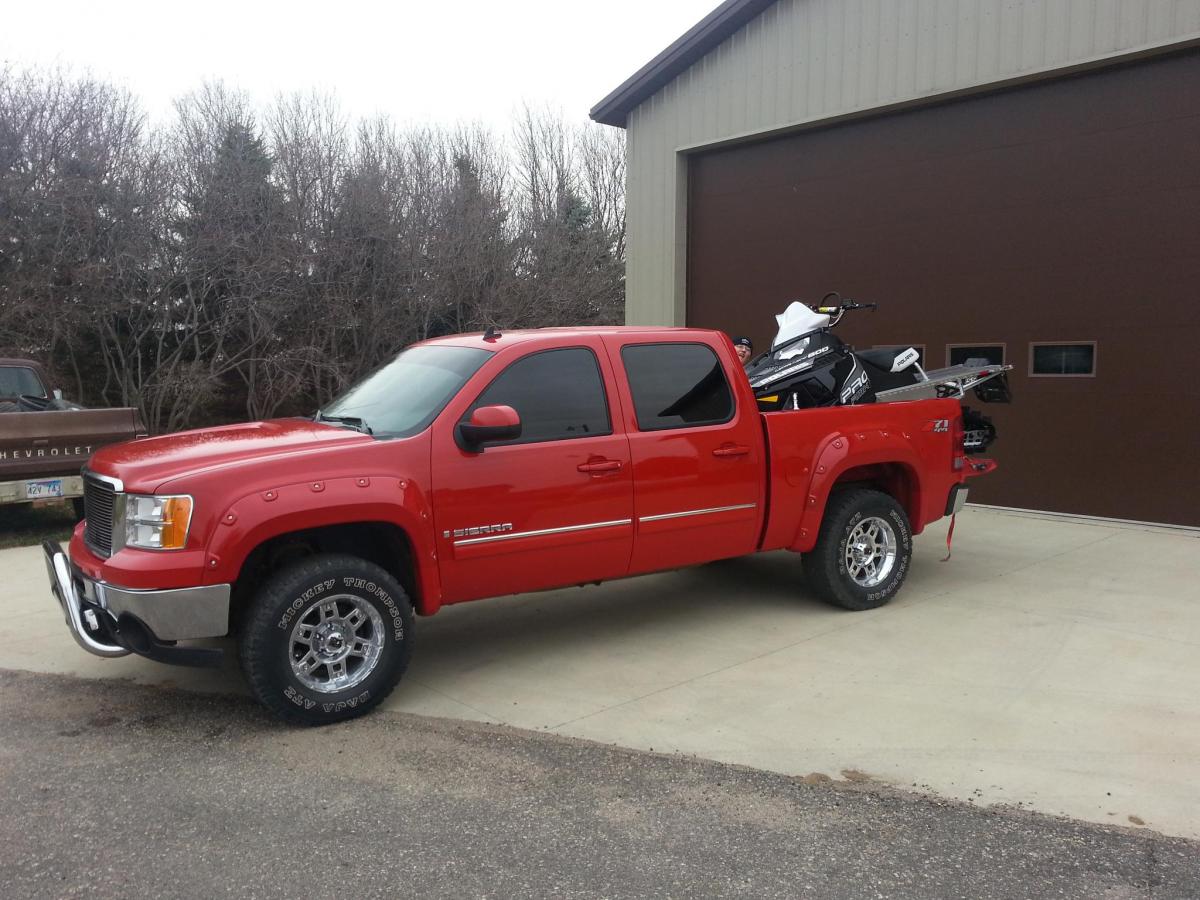

I have an 09 Sierra with a 2" RC leveling kit, 17x9 rims running 285/70/17 tires, so far I have been very displeased with the setup. RC's website said that size tire would clear with the level, nope, lots of rubbing. In my opinion the truck drives worse than it did without the kit, it doesn't track as straight (yes it has been aligned multiple times) and seems like the wheel wants to steer back to straight when turning, not terrible, but noticeable. I put the kit on at about 15,000 miles and now am at close to 70,000. It's been in the shop and had ball joints replaced twice and is now due for another. First time was all 4, second time was an upper, and now it needs another upper and my front tires are basically ruined from the miss alignment caused by the bad joint which caused improper wear which caused a terrible shake and ruined tires. Anyway I'm too the point that I want to get rid of the level, rima(starting to pit) and tires. What I would LIKE to do, not sure if its possible, is take the level out and get new aftermarket rims and tires, I would like to do 18s or 20s, can I make either fit without a level? If so what size or sizes of tires would fit?
I am just at the point where I don't really know what to do next, I am sick of having to have ball joints put in, but I hate to take my level out as I have fender flares and some other stuff that would look out of place if I put stock rims and tires back on, but I am to the point that I need to do something. Suggestions?

Any Front Views Of The Truck? From The Side You Shouldn't Be Having So Many Problems With The Front end.
What ball joints are you putting in the truck as a replacement? I will never install anything but Moog and I believe they make a greaseable ball joint for the non-greaseable factory ones. As far as the wheels they look to be KMC XD Spy's and I believe those come in +18, 0, and -12 offsets. If you are running a 0 or -12 offset then I would definitely expect 285/70/17's to rub on only a 2" level. I feel for you though, many people don't realize there are different offsets to wheels and your situation happens quite often.
