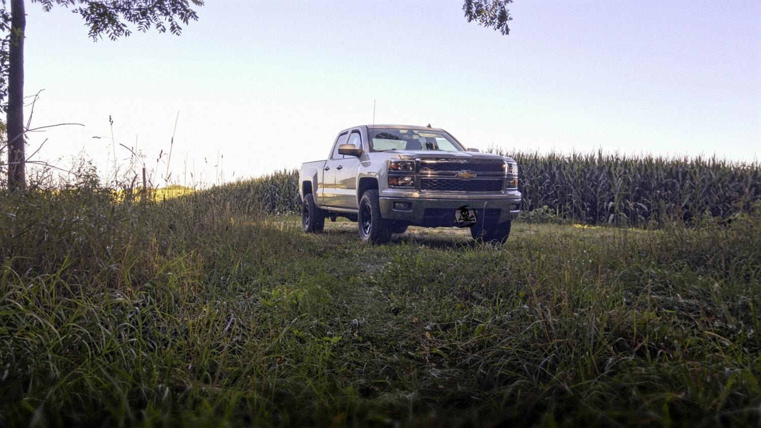

Just letting u guys no I no longer have Rancho quick lift. My rear rs 9000xl left shock went out after 10,000 plus miles. The adjustment would just spin. So I removed and put the stock rear on and it rode a lot different with the front quick lift and stock rear. So I decided on getting new tires which are over 33". Went with 305 55 20 with 2.5 RC level and it rode great but rubbed with full lock. So I just added 1.5" zone body lift to it. Total of 4" lift and I love the ride and no running now. I wish the Ranchos wouldn't of failed me but they did

The plastic adjustment knob is replaceable. I took mine off and lubed inside. It's really just a plastic screw that pushes on a sealed metal piston (valve) inside. Hopefully you haven't thrown them away.

Warranty will cover that.
They also replace the entire shock when this happens done they?
I would be willing to bet they would.
I wish the adjustment knobs were made of a better plastic. Mine were stiff enough that at first I thought I was going to break the knobs too.
i had installed from a local shop I no longer deal with plus I'm not worried about the money. I like to try out new things. I've moved on. I don't even have receipt.
