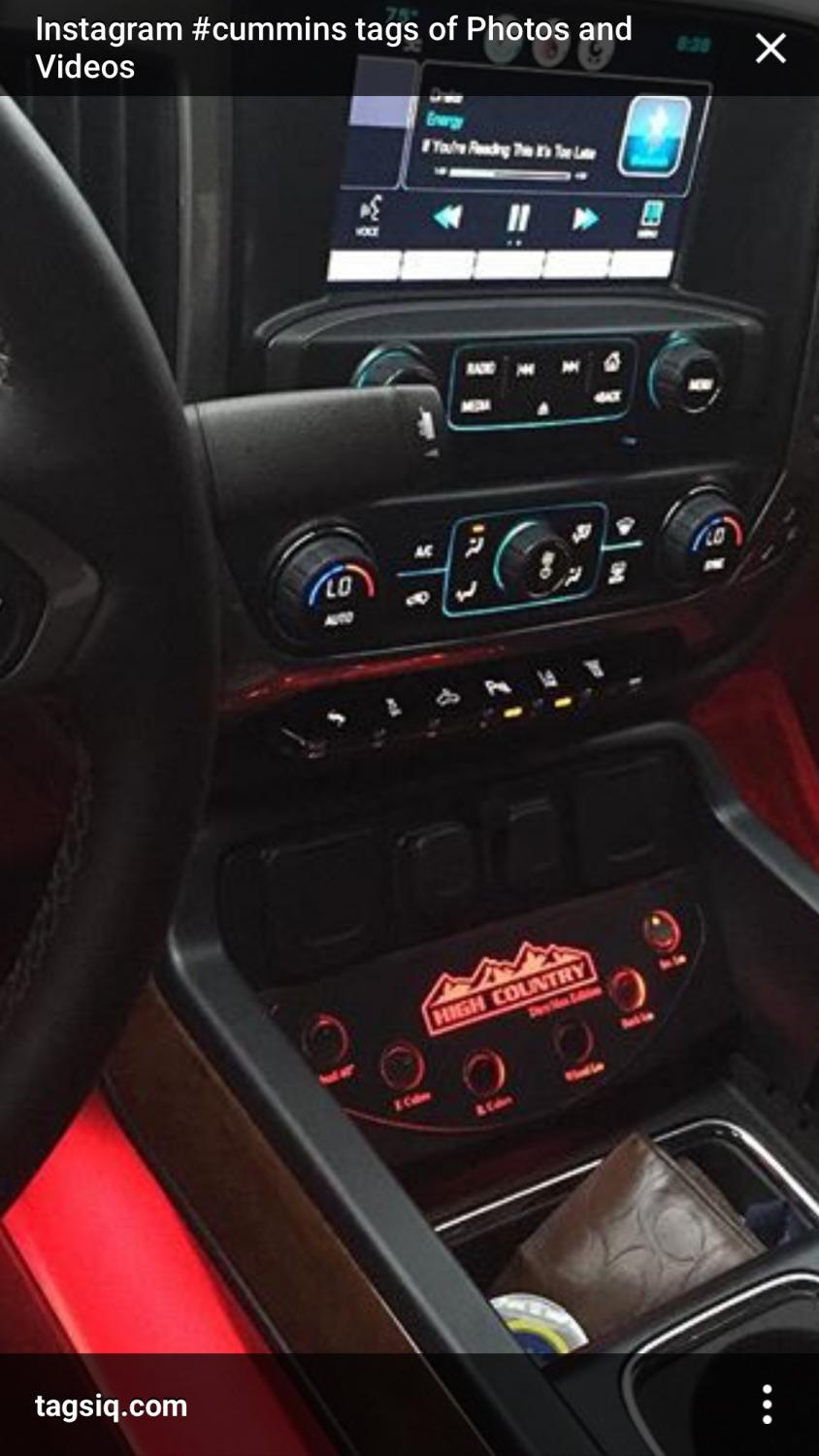

I want to find who made this, and see about having one made that says z71 or something. Does anyone have any idea?
I would really like to see who made this as well....
  • 1 month later...
His instagram is Dirtymax911 and some shop did it for him along with a custom sub box with stuff like this.
