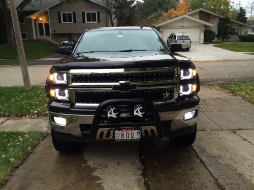

Has anyone done an upgrade to the Anzo headlights on their 2014 or 2015 Silverado? I want to upgrade my LT regular lights to some type of a projector and these appear to be a great direct replacement but i am not sure how the light output is. Can anyone comment?

I've only heard complaints about the OEM and aftermarket projectors for these trucks. Buyer beware.
I'm interested in seeing how these headlights hold up long term. Mainly the halos in them. I'm saving up for LTZ headlights now although I do like these better.
How about the Recon's? Has anyone tired those?? I am trying to decide between the Anzo's, Recon's, or just getting the Morimoto Mini stage 3 H1 projectors and retrofitting my regular lights to have those projectors. I wouldn't get the cool looking LED accent lighting but the projectors are top notch from what i can tell.
