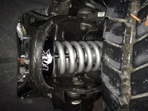

[mention=151356]MRT Motorsports[/mention] if I order a set through you could I have you pre-set them to 2.5” of lift?
They come directly shipped from Fox - with 1.5” of lift stock. Will have to crank them down more if you want more.

I did not my man, to the best of my knowledge they come pre set somewhere between 2.5 and 2.25 inches of lift and stay true to that depending on how much the truck settles after installation.

Okay so I have read through this thread a couple times now and I think I understand what I need. But a quick question first... I have a 2015 4x4 dbl cab. I have been running a 2.5" u-shaped leveling kit up front for a few months now. The truck creakes and moans at low speed. Had a shop look into it. They think it's the leveling kit. All ball joints and axles looked good. They tightened up the leveling kit but it still does it. I hate it and am thinking these will solve my problem as well as give me back my down travel. (Big bumps suck!) Almost positive I have the normal steel UCA's. Do you think this kit will solve my problems?
Thanks!
I know I am over a year late to this.... but if you never figured it out I think I did..... I have the Motofab 2/5"spacers on my 2017 crewcab z71.... after I installed it I was hearing a noise....that noise was the new bolts at the base of the shock where the U - shaped spacer rubbing on the CV axels... it sounded worse at low speeds.... but like all metal on metal rubbing... eventually it will stop.. when they wear down........

I just installed these on my 2015 LTZ. Easy install and great ride. I went with 285/65/18 BFG KO2's

I have the same truck 15 z71 6.2L silverado. What part number is this for the fox shocks? Also do you have steel or aluminum UCA's?
Actually, they come preset with 2" of lift. Talked to a Fox tech yesterday for clarification.
