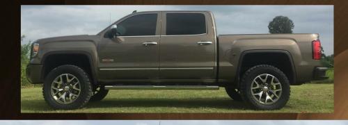

I'm in same boat as you. I love the look of the 3.5 with 35s. Lots of people around here run that set up. Not near the problems that I read on here. These are from local shops fb page post-155890-150155599931_thumb.jpgpost-155890-150155601018_thumb.jpgpost-155890-150155602586_thumb.jpg
I'm in same boat as you. I love the look of the 3.5 with 35s. Lots of people around here run that set up. Not near the problems that I read on here. These are from local shops fb page attachicon.gifIMG_1592.JPGattachicon.gifIMG_1586.JPGattachicon.gifIMG_1587.JPG
It definitely looks good. I just want the annoying kreaking noises i get a low speeds to go away and the ride to be a little better but i guess you can't have it all haha. I am going to keep digging for first hand reviews of the 3.5'' kit and hopefully come to a decision soon.
