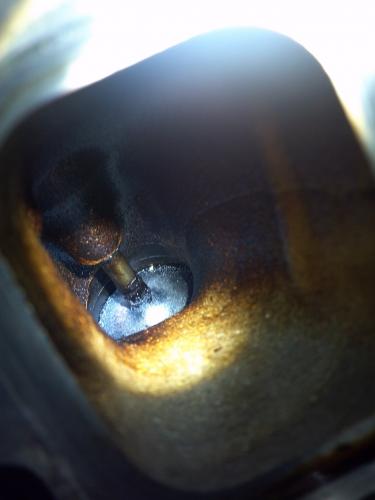

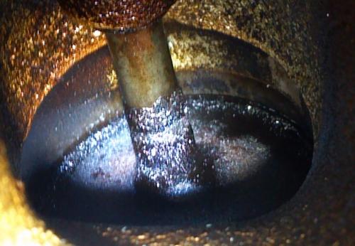

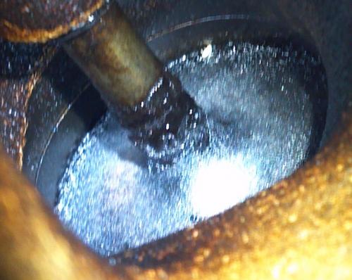

Below are some images from member Gone_Fishing which you can see more off in the thread below. He says during the intake removal the engine only had 30,000 miles on it.
http://www.gm-trucks.com/forums/topic/168709-intake-manifold-off-with-pics-of-intake-valves-with-deposits/
Might be a good time to start looking at preventative maintenance. If left unchecked fuel milage and performance will greatly suffer.

Sorry man but this information you've stated is incorrect. The oil in the throttle body is not from back up as you describe it's from the PCV system. GM hasn't fixed this issue at all. They've attempted to address it by trying to add baffles that trap some of the oil before it gets to the valves but this has been proven not to work 100%. Another user has posted a thread with his valve covers removed on his 2014 silverado and he posted pictures of significant carbon buildup on his valves at only 20,000 miles. Toyota is the only manufacturer I know of that has addressed this and apparently Mazda according to this thread. Unless you have one of their engines, you will need an oil catch can to prevent the build-up on the valves from happening.
