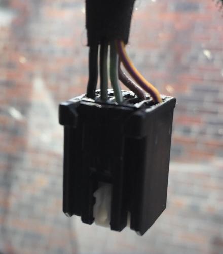

I am also trying to use a mirror tap to hardwire my escort 360 using my mirror power source. Seems like every wire I test has power, some more than others. The black wire seems to have the most. Anyone ever seen these color wires?post-170799-0-61773700-1490208431_thumb.jpgpost-170799-0-61773700-1490208431_thumb.jpgpost-170799-0-12165600-1490208506_thumb.jpgpost-170799-0-45131500-1490208529_thumb.jpg

I am also trying to use a mirror tap to hardwire my escort 360 using my mirror power source. Seems like every wire I test has power, some more than others. The black wire seems to have the most. Anyone ever seen these color wires?attachicon.gifIMG_3026.JPGattachicon.gifIMG_3026.JPGattachicon.gifIMG_3025.JPGattachicon.gifIMG_3024.JPG

Hey Buddy, Thanks for your help. I may be stupid but as you hopefully can see rom my poor photo's, my connector has 5 wires total in it. In position 1 its black, position 2 its gray, position 3 its green/white that's the top row. then on the bottom row, its purple/white in position 9 and yellow/purple in position 10. (and oddly enough, position 1 which is black, seems to have the most voltage.) Seems like everyone says this is the ground. My test light glows bright red on this position???
I used a mirror tap when I installed this same mount in my Cadillac and it was very easy. One wire was hot and the black wire gave no power signal at all. That's why I'm confused-ha!
Can you give us more info on your truck?
Do you have the auto-dimming feature for your rearview mirror? Do you have lane departure warning system?
If you have the auto-dim feature, you can use the exact pins I used to connect....which hot is the the top row second from the far left....ground is bottom row to the furthest right.
I didn't test for voltage, I just researched here for what other guys did with my system and it worked!
Let me know if this helps.
