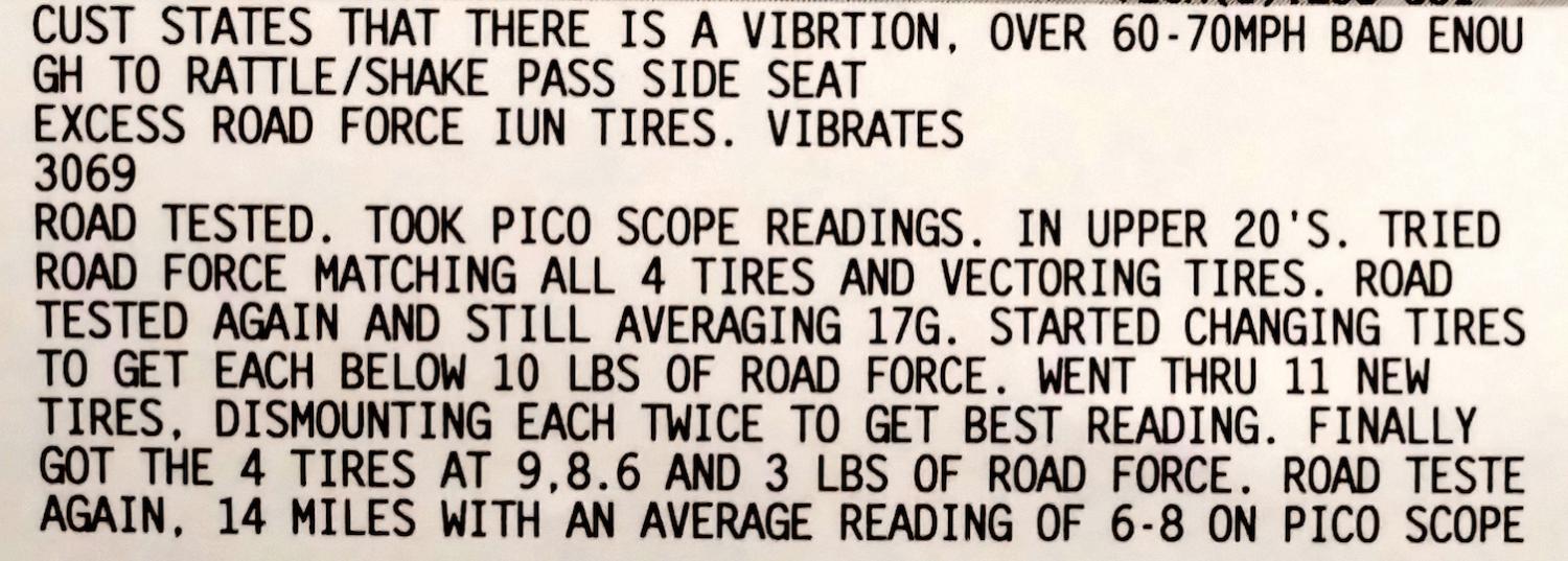

Well.... My 2015 Denali Crew 6.2L 22" wheels with Bridgestone Dueler A/T's... was NOT a Vibrator... But became one!!!
I had approx. 750 miles on it, was on a trip, on the way there all fine, on the way back something changed. It began to vibrate, shimmy, 65mph plus... a 4 hour drive of expressway, cursing under my breath, high blood pressure (i'm sure), misery!

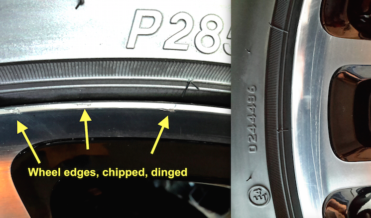

This is what the dealer found, and did. (it helped, but did not bring me back to where I was in terms of smoothness! Also, damage is apparent on my wheels, edges a bit chewed looking, chips in clear coat of wheels, various scrapes, etc.)
This is some of the damage to my wheels the dealer did on my non vibrator turned vibrator...
8 on the scope is noticeable. Just brutal what's with these trucks. This isn't the only forum that has a section on this.
