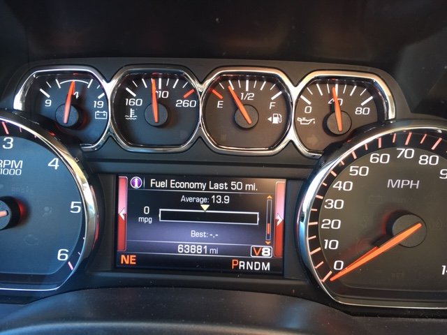

Problem now is that I have recently replaced that battery an it has been to the dealer to fix the A/C (the known issue on this Forum) and not it has not moved.
It has stayed at 13.9 for the "Average" and "Best" for a while now....
Not sure if something got jiggled or?
Do not even know where to look to try to troubleshoot.
When they did the battery swap - they did plug in a unit to keep the settings......
It still shows it increasing and decreasing while driving--- just no change....
Before I would at least get a ball park mpg - now it does not change......
Is this a symptom of something bigger?
