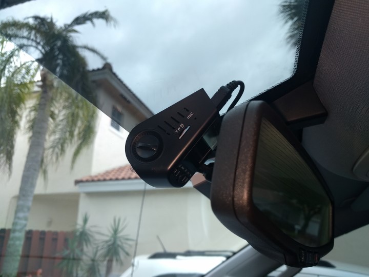

my setup:
Ran down the a pillar to the fuse panel.
Tapped the Purple/White, its ignition switched, grounded at the bolt.
