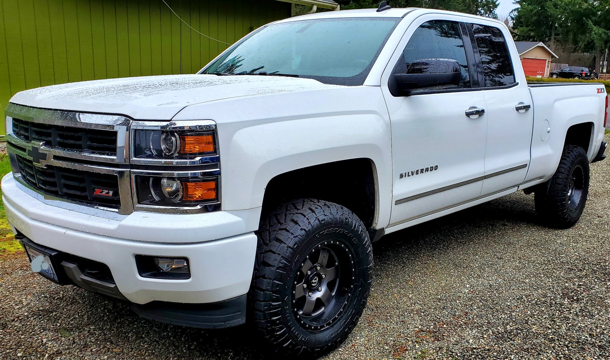

No trimming with 295/70/17 Ridge Grappler on 17x9 +1 offset and a 3 inch level kit on my 2014 Silverado.
post your pics

NWdirt, looks great.  I'm going with 17x8.5 Icons w/0 offset and P285/70-17 Wildpeak AT3's, the P being the key there, I think the difference in unsprung weight on each corner with these vs the LT tire will make a diff on a half ton truck.  Not doing a bunch of heavy hauling or serious offroading, so don't need 10 ply tires.

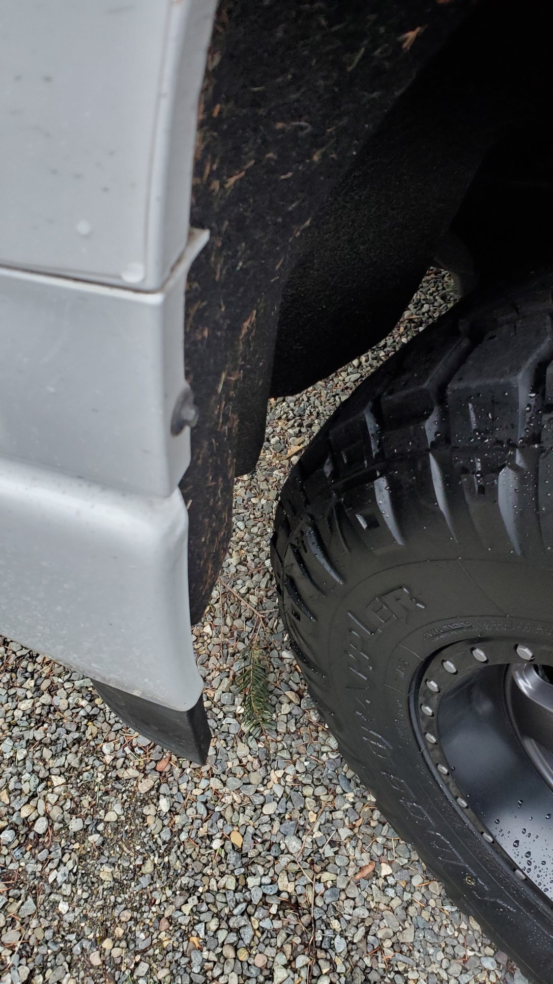

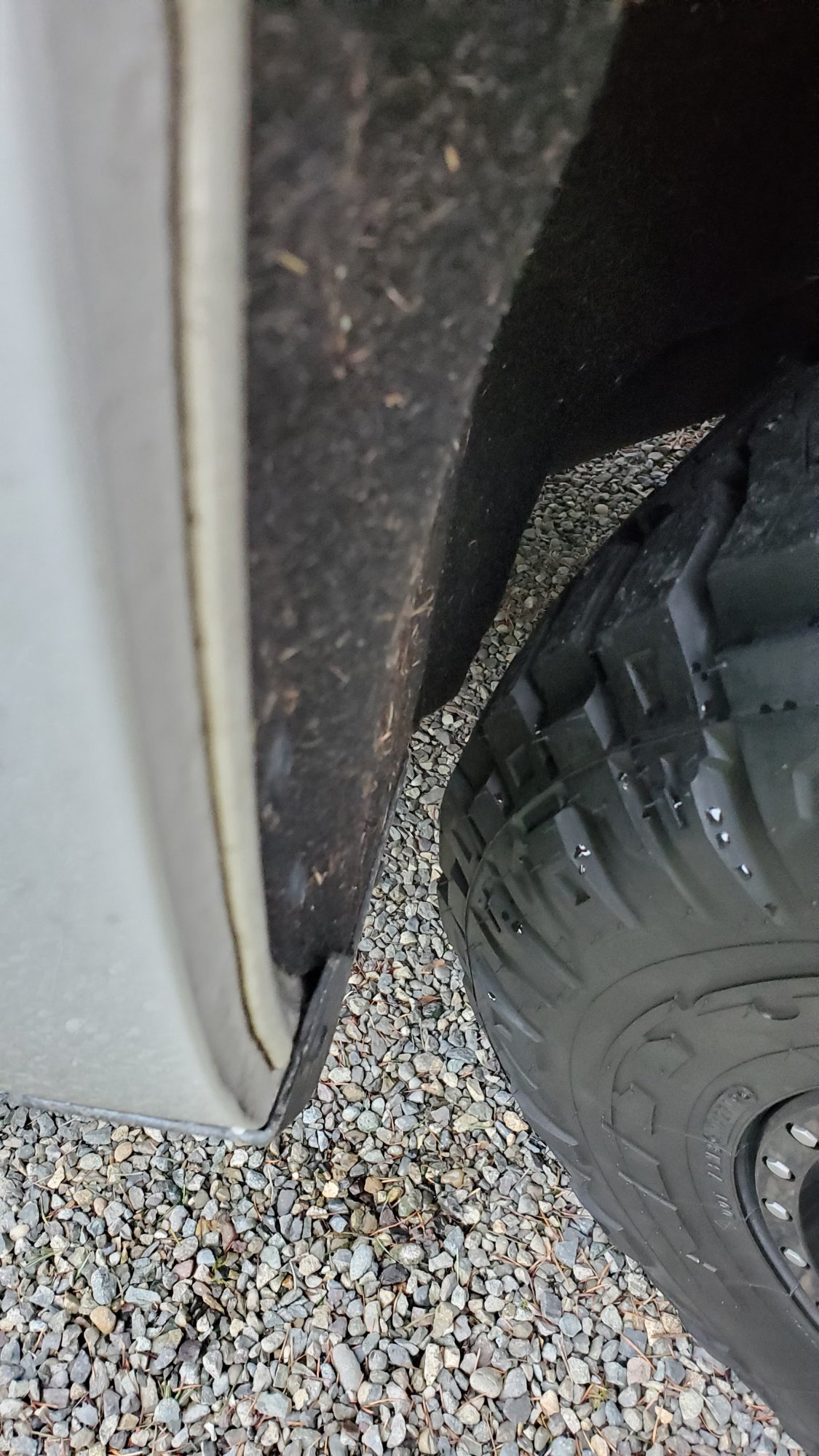

I just put my tires on the other day. It rubbed a bit but I trimmed it and did a mini NorCal mod
wouldn't a  chassis lift might be a better decision  for wheel clearance...instead of grinding the fenders
Gonna do this at some point too. 285/75/17 on methods with a 2.5” Coilover level in the front. Here’s a clean video for the k2 trucks for the NorCal mod. Can also do the zone trim plates that clean it up a little bit better
Um, no.  Won't be doing that on my 2018.  Did such on a 97 Z71 that was near 10 years old, but not worth it on a nice newer model truck.  Sorry, I just don't see the point, or the point in wheels that have that much negative offset.  To each his own, just not my style.
