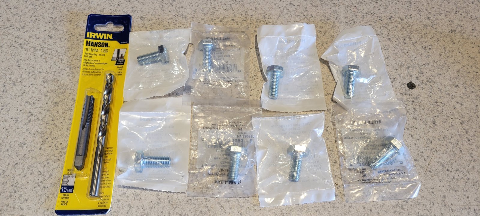

Can anyone confirm the actual bolt size for the two under-engine skid plates as well as the transfer case skid?  I'm seeing conflicting reports.  Either M10x1.50 with a 25mm length OR M8x1.25 with a 30mm length.  Which one is it?

That's the information I thought was correct, but I'm being told it's a different bolt by another guy.  I haven't installed my plate yet and the bolts and tap I bought today are for 10mmx1.50 thread as you said.  So, if what you are telling me is correct, what I bought is correct.

I just ordered the skid plates yesterday.  I haven't taken any bolts out yet.  You are correct from what I hear the front metal plates, which there are 2 of, use 4 bolts each, and the transfer case skid uses 4 bolts.  So as of right now I have more than enough bolts to complete the job.
