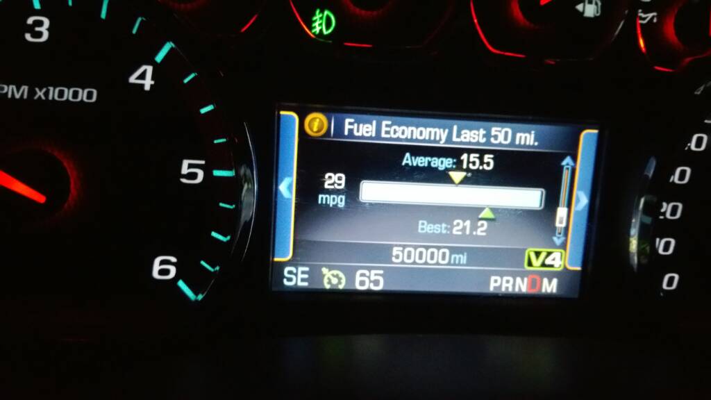

Here is my difference from summer to winter gas avg
Sent from my Note 4 on Tapashit
