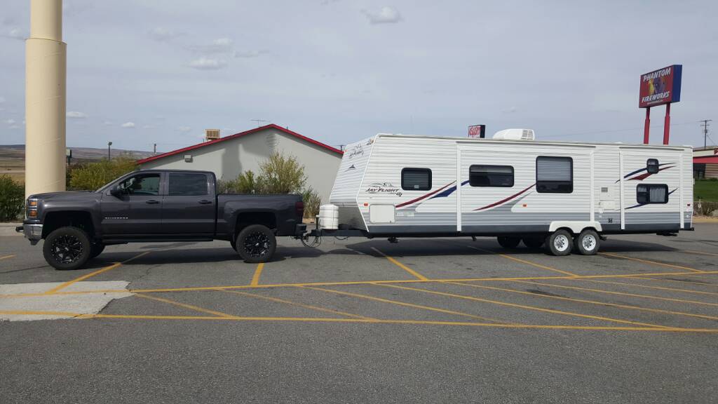

3.08 and 35s. Noticeable but not a deal killer. Pulls just fine. Want to regear, couldnt afford it. Had to suddenly move across country pulling my 10k camper loaded. Truck and trailer scaled at 15500. Went from Salt Lake city, Utah. To Nashville,TN. 1650miles. Pulled great. Never got over 215 on Temps. Also don't care what you think about the weight. Only letting yall know it will do I without breaking a sweat.

Yes. Not into overdrive tho. Was able to set the cruise at 65-70 most of the way. Fuel mileage was less then acceptable though.

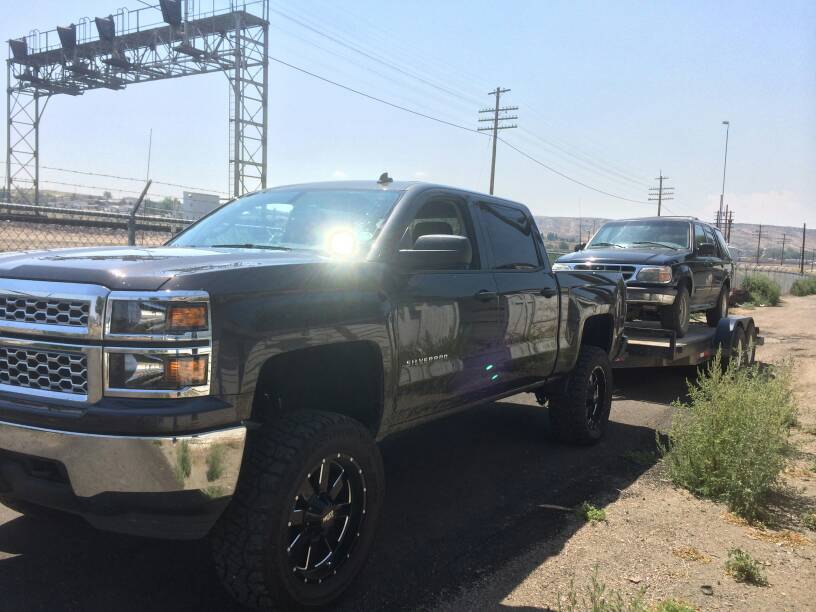

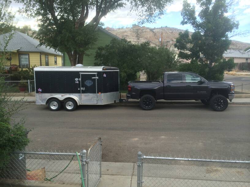

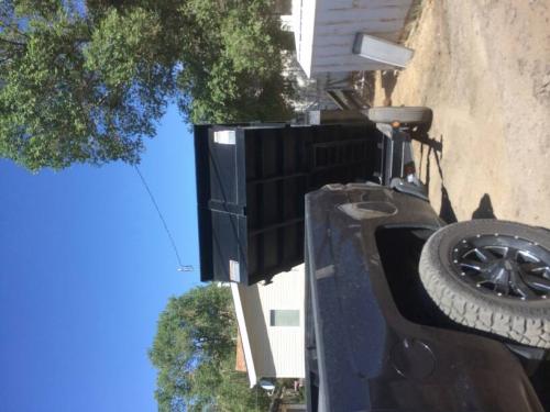

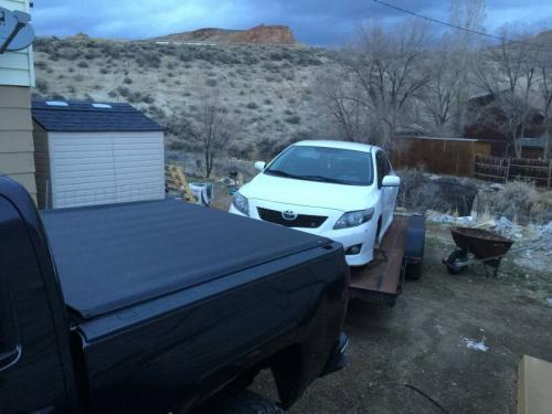

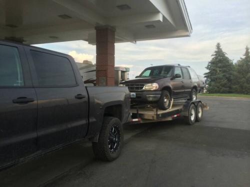

After the cross country trip. I wouldn't even hesitate on a 200 mile camping trip. Ideal? No. Once I get the funds I want to get 4.56s put in. I'm no stranger to towing. Haha.

The truck wasn't even rated to tow that camper in the first place, let alone with 3"+ taller tires on it. And 5th and 6th gears are both overdrive gears in the 6 speed
